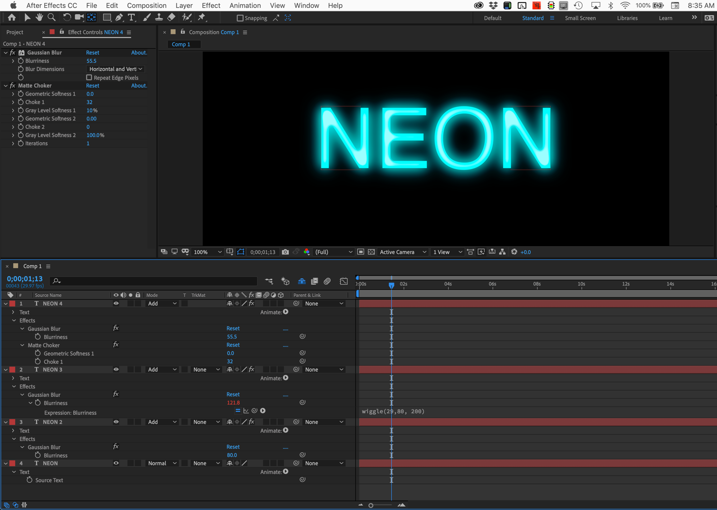

Probably the easiest thing to do is to duplicate the shape a couple of times, add a blur to the top copies, set the blend mode of the top copies to Add, maybe lighten the color of the top copy a bit and add a matte choker and end up with something like this using only a single text layer. it took less than a minute to create. The screenshot should give you everything you need to recreate the effect.
Then if you really wanted to get creative you could pre-compose that layer, make it 3D and put it in front of a light and use it as a projector to throw light on a 3D layer below it and give it a nice glow. Here's a tutorial I did a zillion years ago that shows how to do that. Using Projection Layers to create a gobos and projector effects
That will get you started. There are dozens of ways to pull this off. The most efficient workflow depends on the design and the images you have to work with.
