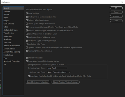

Here's what I know. You have 7 layers in a timeline that is more than three minutes and thirty seconds long, and the layers are all stacked up on top of each other for the entire duration of the comp.
Here's what I can guess from your description: There is an option in Preferences/General to Syncronize Time of All Related Events. Make sure that is turned on.
One more note: * The "Drag & Drop here..." area is buggy and should not be used to share images. Please use the toolbar or just drag your images to the reply field. You can even copy an image file and paste it to the reply field on the forum.
Explorer ,
Oct 24, 2021 Oct 24, 2021
It's already on in my Preferences. I attached another screenshot here in case there is anything else in my General Preferences menu that might be off. My project isn't too big or complicated, so I am wondering if it would be worth it to just create a new project and copy paste the layers and compositions there and see how things turn out?
