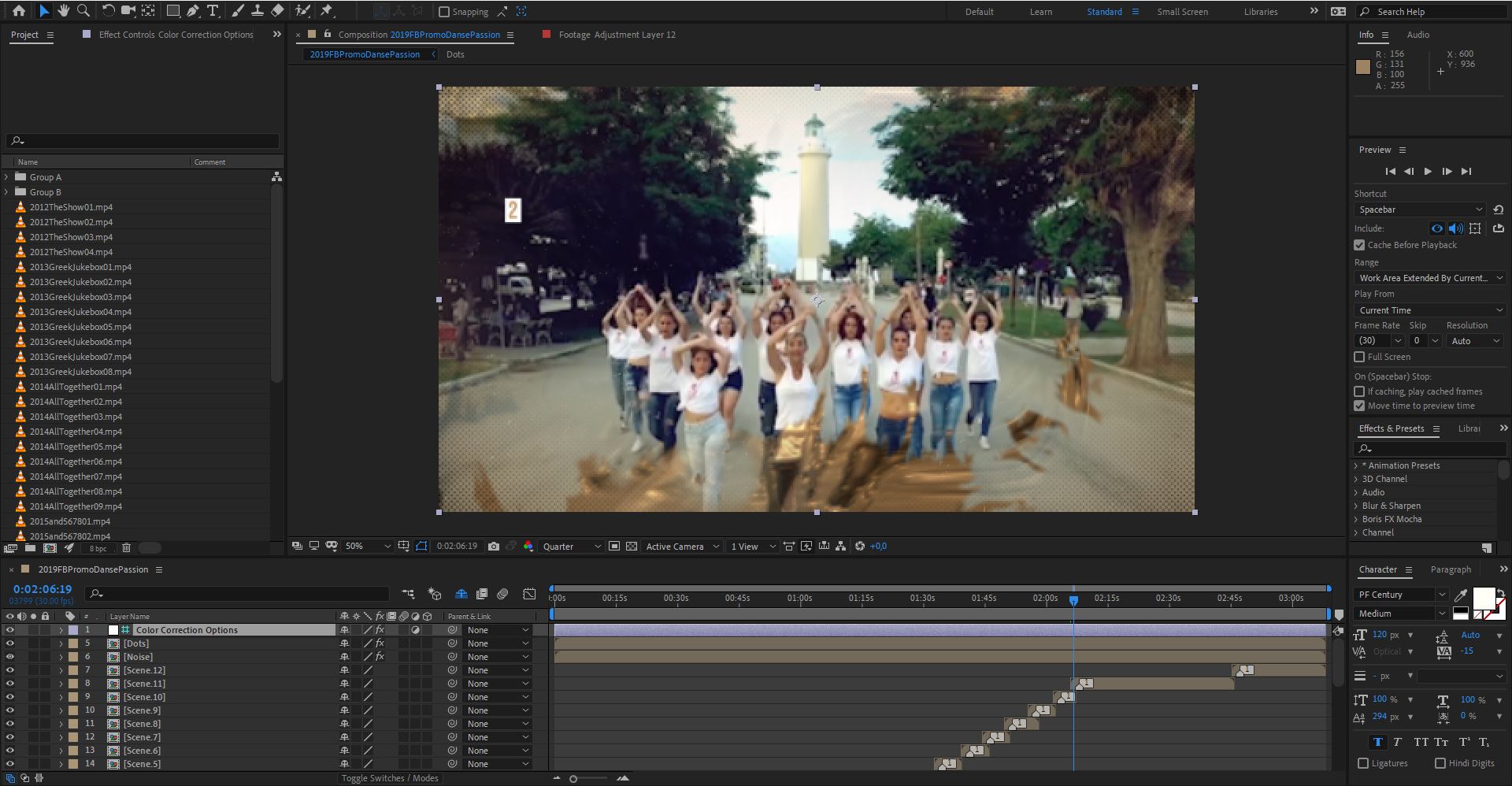

I mean that in the preview window of the [Scene.X] comp (in the picture below, I am showing the preview window for the all composition, however it's the same for the scene comp), it renders only the [text] comp with its effects and not the [media] comp, which renders only for the 9s.
At this point, the preview of Scene.11 starts. If you can see, top left, the Text.11 comp (with the "2") starts to appear.
7s (not 9s) in, the full scene has appeared:
and then this

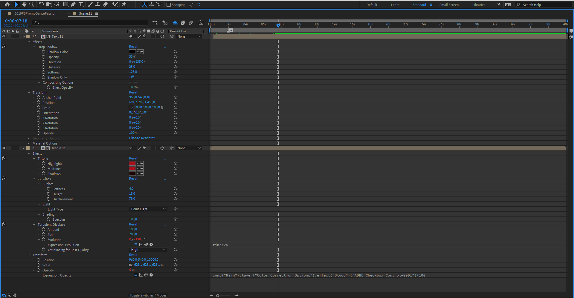

the video disappears. I did some more searching in the layers and found that there is an effect with scripting, in the media comp, but no keyframes:
If I press "Enable Expression" in the last line (Opacity) and disable the equal sign, then the video shows, but the transition effects from the previous scene to this one, disappear.

If disabling the expression brings the video back, then sounds like the expression has a hard-coded end time entry. Contacting the creator would be your best bet or post the expression.

Hi! It doesn't appear, on the surface of it, that the expression is hard-coded time - at least in itself. It looks more like your Opacity is being cranked to 0 by a layer called 'Color Correction Options' in the comp 'Main.' There are so many moving parts it's a bit hard to tear apart with this level of info regarding comps, layers, and intended look.
