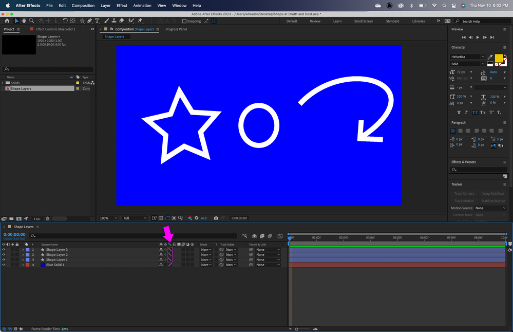

It looks like you have the Layer Quality set to Draft.
Do you have a project that you can share?
Shape Layers look fine on my end.
Layer Quality Switch set to Draft for Shape LayersLayer Quality Switch set to Draft for Shape Layers
Layer Quality Switch set to Best for Shape LayersLayer Quality Switch set to Best for Shape Layers
