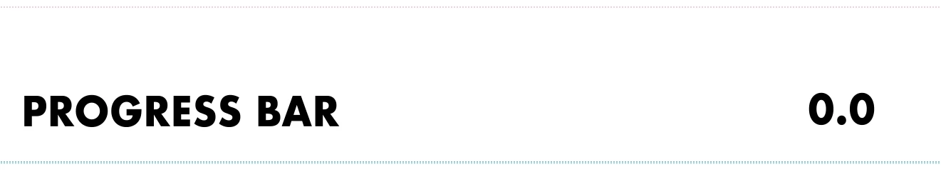

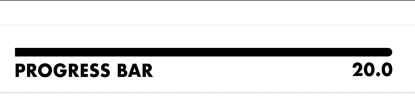

Hello! In part of my composition, I have a "progress bar", which is connected to a number and reaches it's 'end point' when that number reaches a certain value. Here's a visual representation :
As you can see, when the number reaches 20, the progress bar reaches the end, and it progresses continuously as the number approaches 20. Here's what the expression for the mask looks like :
linear(thisComp.layer("NUMBER NULL").effect("Slider Control")("Slider"),0.0,20.00,-27.9,36.2);

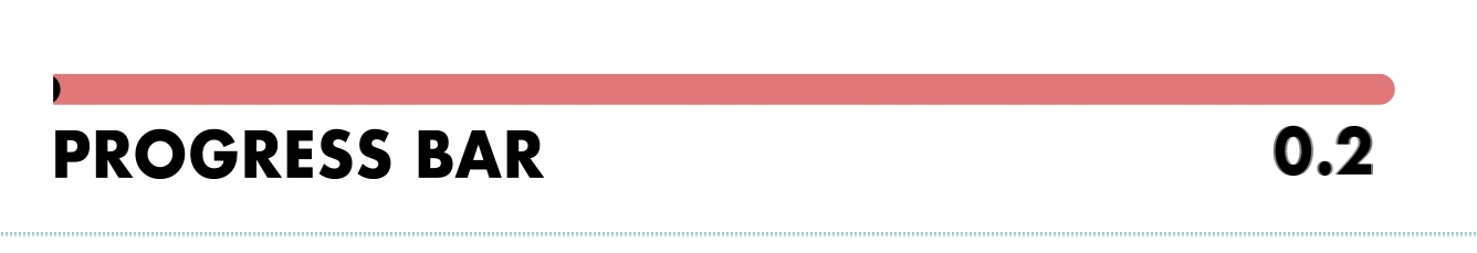

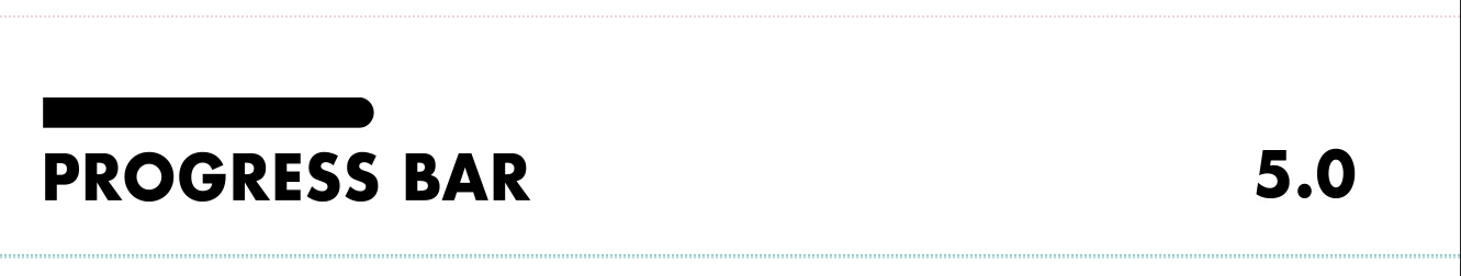

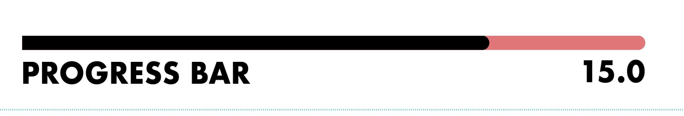

I created this progress bar using two shapes : one shape that looks like the last picture, where I applied a mask so that the left side looks like a rectangle edge whereas the right side looks more spherical. I then duplicated this shape and hid it. The second shape acts as the actual bar, so that I can move it all the way backwards to say, 0.2 seconds, without you seeing the rest of the bar. Here's what it looks like if I allow the background bar to be seen :
My issue is, because these are technically two shapes, whenever I want to apply an effect to the progress bar, like drop shadow or glow, it is partially obstructed and doesn't surround the entire shape (because it isn't just one shape). I was wondering if there was another way to make a progress bar that didn't require me to make two different shapes so I could apply effects to it. Thanks!

This is how I would do that:
All of the appropriate properties have been tied together with simple expressions.
I've shared the project file.

No, unfortunately there is no way to isolate effects to just specific shape groups. You can't really avoid using two layers or more if yo want to go fancy with effects.
