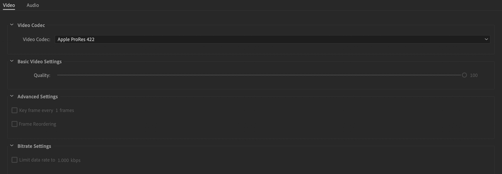

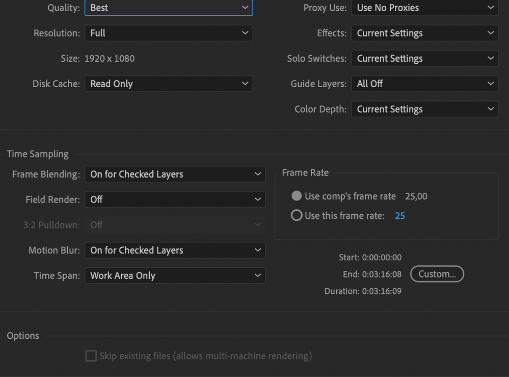

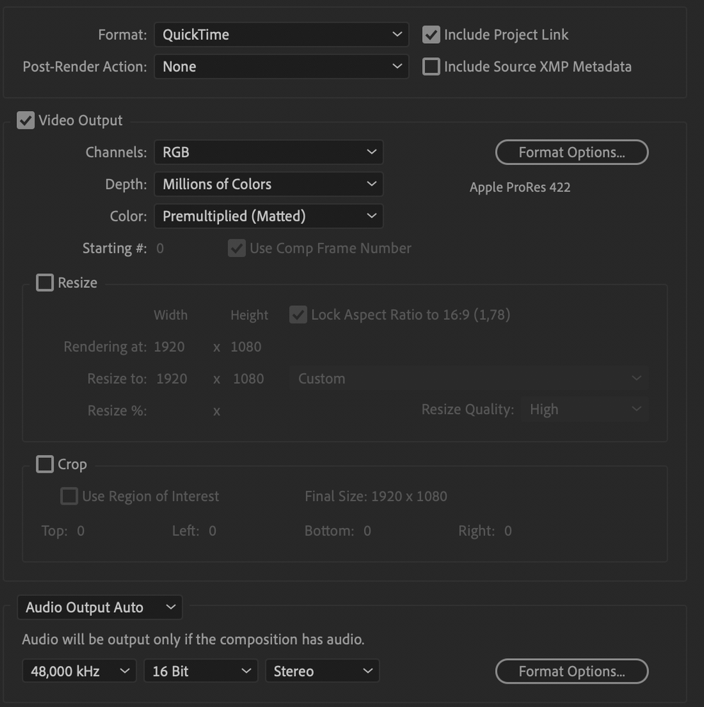

I'm working in HD. Hmm, how am I rendering? File -> export -> Add to render que. here are my settings. Field order is turned of. Bildschirmfoto 2020-02-22 um 18.42.18.png

If those are your render settings you did not create an interlaced file. You should be able to see if it is interlaced by checking the properties in the Project Panel when the footage is selected or by checking the footage interpretation.
If it is interlaced you will see it there.

You need to check your render. If you rendered with those settings you do not have interlaced footage and something else is going on.
