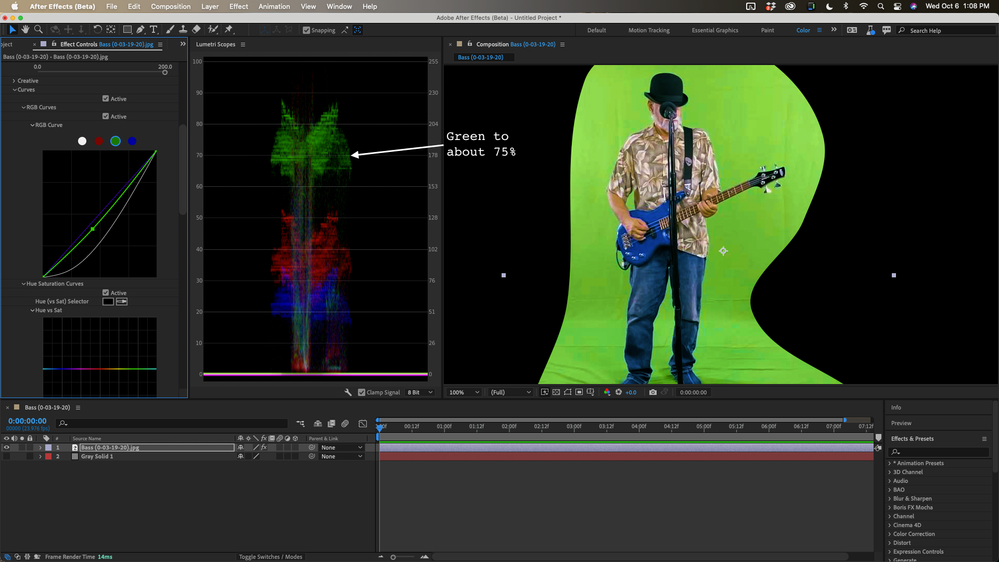

The first color grade:
I always use the Color workspace and the scopes when I'm setting up a key so I can see what is actually going on in the comp.

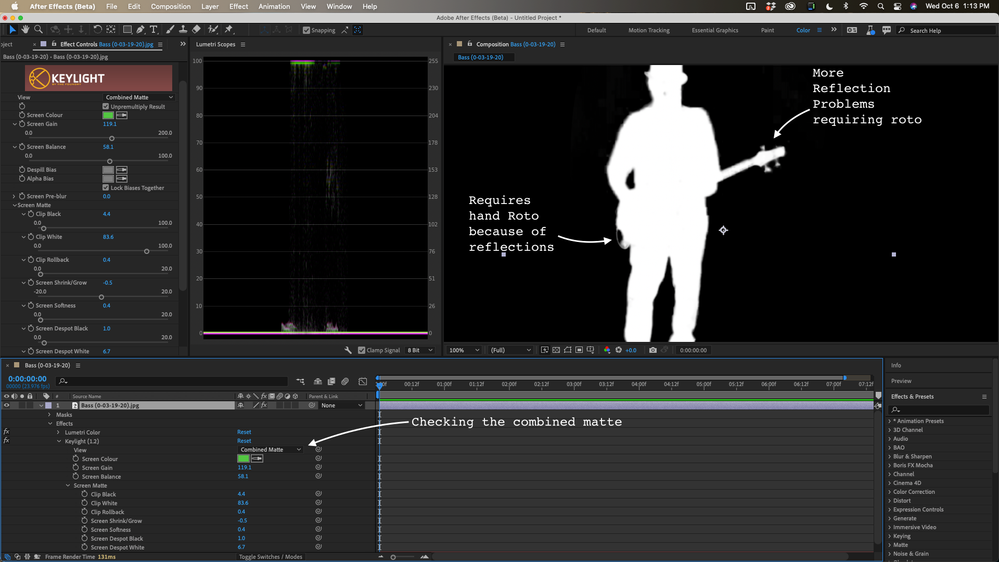

Checking the matte:
I also step through the viewing options in Keylight to make sure I am getting the best matte possible.

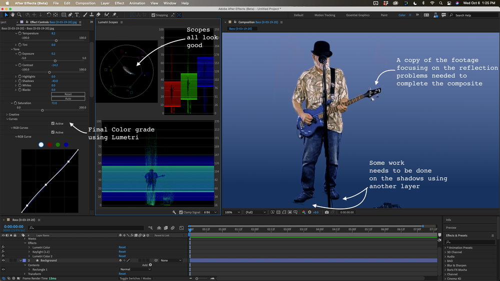

Almost the final:
Additional color grading is almost always required after you pull a key. With this shot adding a second instance of Keylight was sufficient. Sometimes I use the keyed footage as a track matte, most of the time, there is more than one copy of the original footage in the final composite.
I have had composites like this take up to 10 copies of the original footage and a bunch of different techniques. The footage is pretty good but could have been exposed a little better, but the frame you shared is good enough to get a good key if you work at it a bit.
