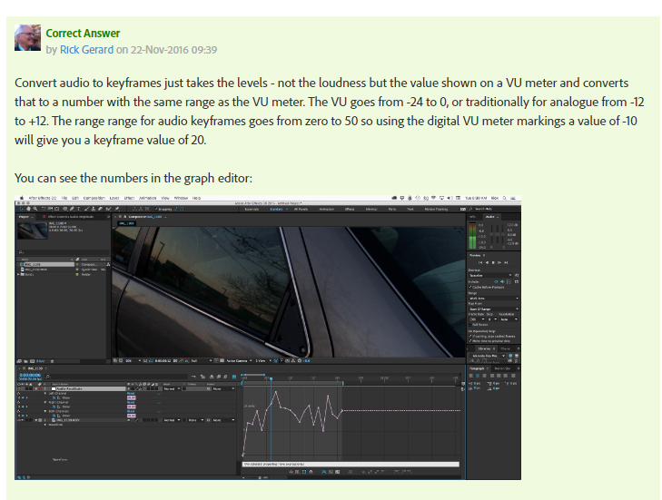

Here is the answer from Rick Gerard on the general forum, thanks Rick.
