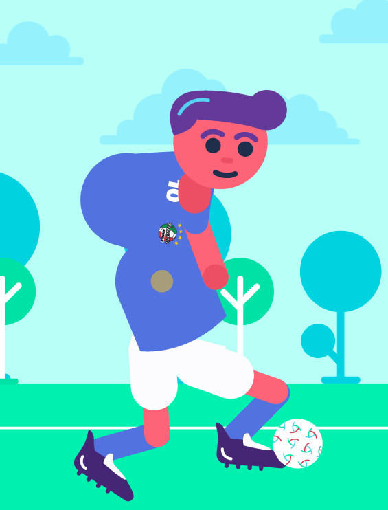

I made a complex animation in a composition that's 1000px x 1000px with 60fps and I need to have it on 800px x 800px with 30fps. I scaled the composition with the AE script and it worked fine for the background and other animations I did but the character I rigged with Duik Bassel 2 didn't scale down. My Body limbs don't work fine and the fps change doubled the speed of my animation. It's very complex and I'm kinda lost thx for the help
