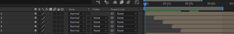

Hey, this is my second post. So i have made this far. I want to make a comparison. I have a problem,
Right now it just down scale instantly.  i want when it scale down it have a shrink animation maybe about 2 second.
Here's the video (i speed up the video 250%):
https://youtu.be/3vph9YaWa4A
Here's my timeline:
Here's the code:

The screenshot just tells me you have 5 layers that have a layer color of brown.  I have no idea what is going on in the comp. Please don't post screenshots without selecting the layer you are having problems with and pressing the U key twice to show us what you have modified on the layers.

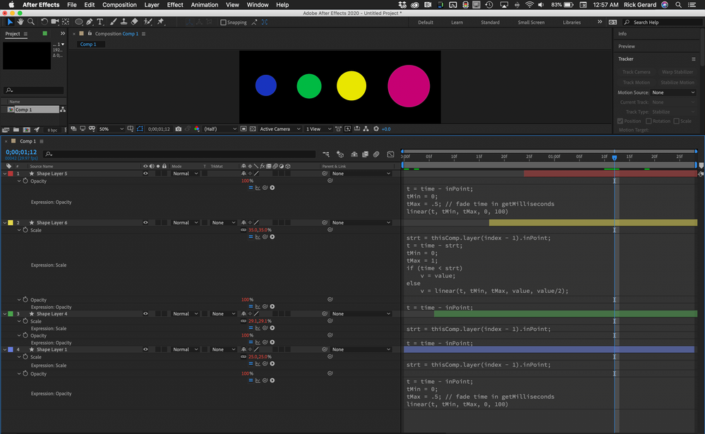

If you used index -2  you could put the text layer above the graphic and get a comp that looks like this:
Here's the project file:
https://www.dropbox.com/s/4n4bamdmnmddj8a/scale%20and%20fade%20numbers.aep?dl=0
