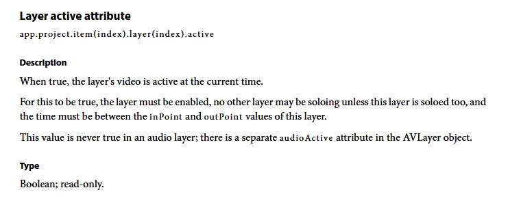

Sorry Alan,
I didn't understand it.
And I'm not sure if I do undestand it now...
Page 87: http://blogs.adobe.com/wp-content/blogs.dir/48/files/2012/06/After-Effects-CS6-Scripting-Guide.pdf?f...

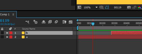

Engaged ,
Dec 18, 2018 Dec 18, 2018
Layer a, is active, and layer b is inactive, not to do with selection.
