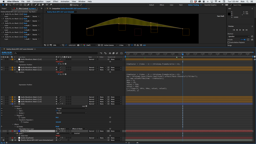

I think the easiest way to do this would be to create a matte for a shape layer with a single vertical line and a repeater. You could use the Create Nulls from Paths.jsx script that comes with AE to attach nulls to a closed path (a mask on a solid). Figure out how many curves you want, create that number of points on the mask, then tie the position of the middle nulls to the value of Both Sliders on the Audio Amplitude layer with each point delayed a little by time. I threw this together in about 15 minutes. there are only two sets of points between the start and end of the path and I delayed the top right and bottom right response by 8 frames to give me a wave. This is what the comp looks like:
Here are the expressions for the top and bottom pair of nulls.
// Top set of nulls
timeFactor = (index - 1) * (thisComp.frameDuration * 8);
Amp = thisComp.layer("Audio Amplitude").effect("Both Channels")("Slider");
t = Amp.valueAtTime(time - timeFactor);
tMin = 4;
tMax = 25;
value1 = 500;
value2 = 350;
y = linear(t, tMin, tMax, value1, value2);
[value[0], y]
// Bottom set of nulls
timeFactor = (index - 3) * (thisComp.frameDuration * 8);
tMin = 4;
tMax = 25;
value1 = 500;
value2 = 350;
[value[0], y - 100]
The first line multiplies the index of the layer - 1 by the frame duration of the comp times the number of frames to set the delay. Because I put the top left null at the top of the comp the value of the time factor is 0 but on the second layer the time is 8 frames after the first layer moves. Did you follow that?
The second line of the expression defines Amp as the value of the Both Channels slider in the Audio Amplitude layer. The third line defines "t" as the Amp value at the adjusted time. Because the adjusted time for the top layer is the layer time the null is going to move when the Amp value changes, but the second null, on the second layer is not going to move until 8 frames later.
tMin and tMax are the minimum and maximum values of Both Channels generated by the audio file I added to the comp.
value1 and value2 are going to be the maximum and minimum values for Y.
A simple linear method directly from the Expression Language Menu/Interpolation choices gives me the Y value. Then a simple array completes the expression taking the current position of X and using the interpolated value for y.
The only difference between the top and bottom null layer expressions is the index - value. I set it to 3 so the bottom left null would react in realtime to both channels and the bottom right null would react 8 frames later. I also subtracted 100 from y in the bottom two nulls to establish a minimum thickness for the wave.
The last step was to just set up a simple shape layer with one vertical line with a 4 point stroke, add a repeater, and adjust the number of copies and the x offset. Set Matte was used to mask the layer using the Solid with the animated mask. You could also have just used a Track Matte.
Duplicate this comp, change the color of the lines in the duplicate and adjust position and maybe scale, and maybe even offset the timing and put them both in a new main comp and you would have your design. To get the exact shape you are showing will take 10 points on the mask path and some tweaking of the Bezier handles.
As I was finishing up this post I had another thought. You could use this same linear method idea to control Wave Warp and get a simpler effect. I think the most controllable design would be the animated path as a matte method I described here, but using Audio Amplitude to drive Wave World would be much easier to set up.  Both of these solutions are going to be a lot easier to set up and faster to render than trying to animate the length of a couple of hundred vertical lines.
