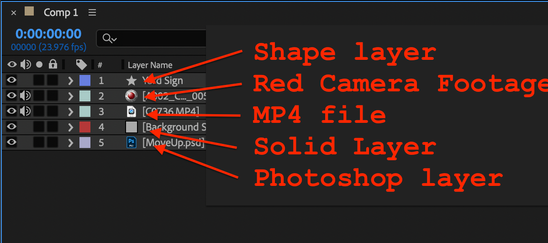

Is there any reason for this star?
Apr 23, 2025 Apr 23, 2025
The icons indicate the kind of layer you have in the timeline. Stars are Shape Layers. Each type of footage or asset has a unique symbol. All of this info is in the User Guide. Here is the section on the layer panel UI: https://helpx.adobe.com/after-effects/user-guide.html
Try that link.
Unfortunately the Search Help field has been removed from the top right corner of After Effects so you now have to just use the Help menu and navigate through the website.
Thanks. Above link is not found.
