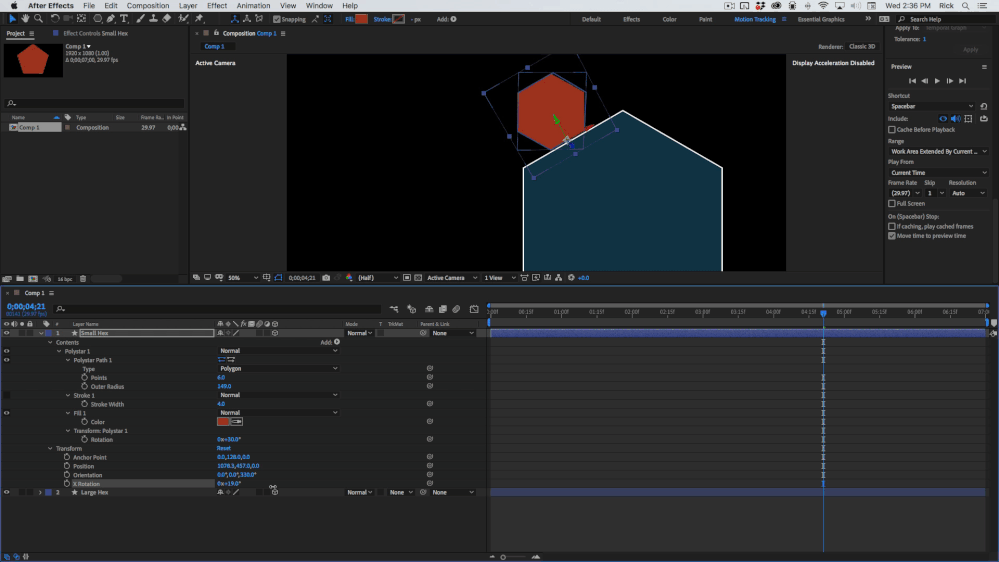

Adding a null and all the monkeying around is not necessary. You just have to do a little math. The math is really easy if your Hexagon is a shape layer.
Start by creating a Polystar using the Polygon Tool and make the layer 3D. When you have created the Polygon select the layer and press the U key twice to reveal all the modified properties. Spin open the PolyStar 1/Transform Polystar 1 properties and reset the position to 0, 0 then set the rotation to 30º and zero out the position property. Spin open the Polystar 1/Polystar 1 Path property and set the number of points to 6. You should now have a hexagon oriented with the bottom lined up with the X-axis.
Change to the Anchor Point (y) tool and turn on snapping. You can then drag the anchor point to the bottom center of your hexagon. Change to the Selection tool (v) and drag the polygon to the edge and center of the second hexagon.
The last step is easy. Press "r" to reveal the rotation properties. 3D Layer rotation has 4 elements that can be animated. Orientation for X, Y, and Z, and X, Y, and Z rotation. Set Orientation to 0, 0, 330 or 0, 0, 30 to line up the base of the hexagon with the side of the other hexagon. All that is left to do is animate the X rotation value.  No matter how many sides or how odd your shape is if you can figure out the angle of the side you want to match, you just rotate the Z orientation to match that angle and you can then easily animate the X rotation to get the layer to spin around X.
My screenshot shows you everything I did to the layer. You should be able to figure it out from here.
If you have a nearly vertical edge you want to match up you would still adjust the orientation Z value to match up that edge, then animate Y instead of X. It's all pretty easy once you get the hang of it. If you have your 3D cursor set to Local Axis it's really easy to see how things are lining up.
