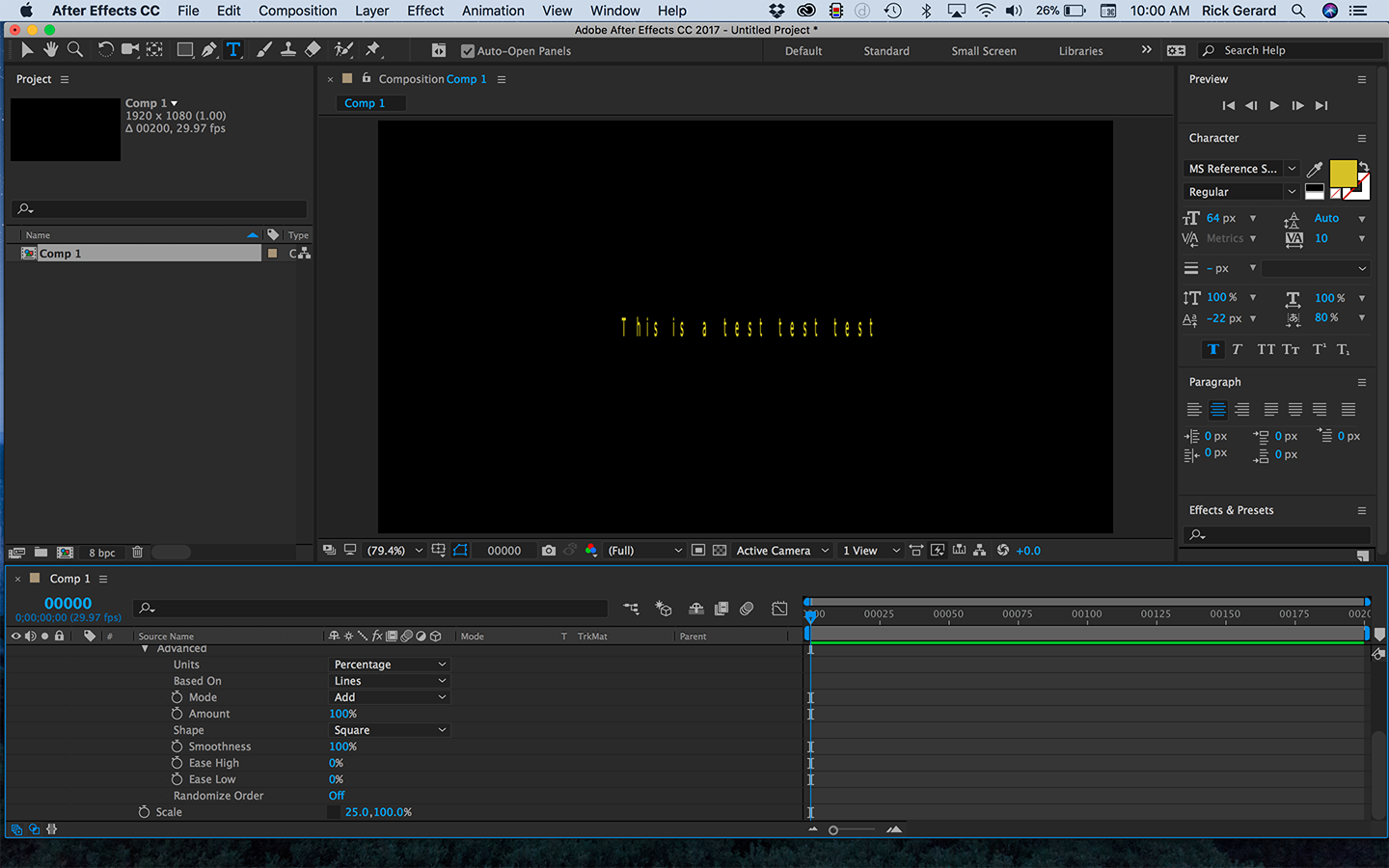

The reason that the text is not scaling is the range selector setting. Try setting
Your sourceRecAtTime method gives you the width of the text that is entered. Adding a text animator for scale is going to change the scale of the individual letters but not the width of the text unless you animate the kerning. Without the expression just add a scale animator and change the X scale to 20%. You'll get this:
SourceRecAtTime will change when you change kerning or when you add characters but it's not going to work for your application. As Roei suggested you need to be counting characters.

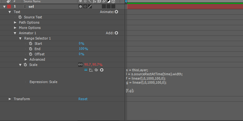

I found the first issue that didn't allow my expression to work, apparently I can't use the command "sourceRectAtTime()" at text menu on the same text layer. There should be some middle object to read the source Rect, and then I read it again from that middle object.
Explorer ,
Oct 08, 2017 Oct 08, 2017
This is the way I could use sourceRectTime instead of length, so the tracking is a bit improved (text_02 is the middle object):
