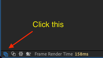

Jul 09, 2022 Jul 09, 2022
Click this expand or collapse the layers switches button (check the image below)
You want to expand the Layer Switches Pane or the Transfer Controls pane.  When both are collapsed, there's nothing to toggle.
Click the "Expand or Collapse Transfer Controls pane" button at the lower left of the Timeline panel so that it's blue (enabled) and showing the Modes.  You will then be able to click at the bottom of this pane (or column) to toggle between showing Switches or Modes.  Or click "Expand or Collapse Layer Switches" to the left of it.
