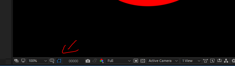

use this to get the masks back
you are correct about the behavior:
if you hide the layer controls (Ctrl+Shift+H) or press the toggle mask and shape path visibility icon, and rotate the layer or change the anchor point with the anchor point tool (which is not intuitive because you are missing the layer controls) , then if press Ctrl+Shift+H, the mask path and shape visibility is not back on with the layer controls. you need to add it manually.
from checking other version, it appears this was always the behavior.

Thanks RT for the reminder of the button.
I have mostly ignored these buttons as they can nearly all be done with Keyboard Shortcuts.
One click is better than a CtrlAltU click
