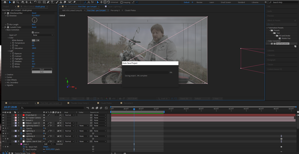

My 2nd question is -When I turn on the 3D tracker camera layer, the whole precomposed comp I'm working on makes the main comp have a blank preview as you can see from one of the screenshots. Why would that happen?

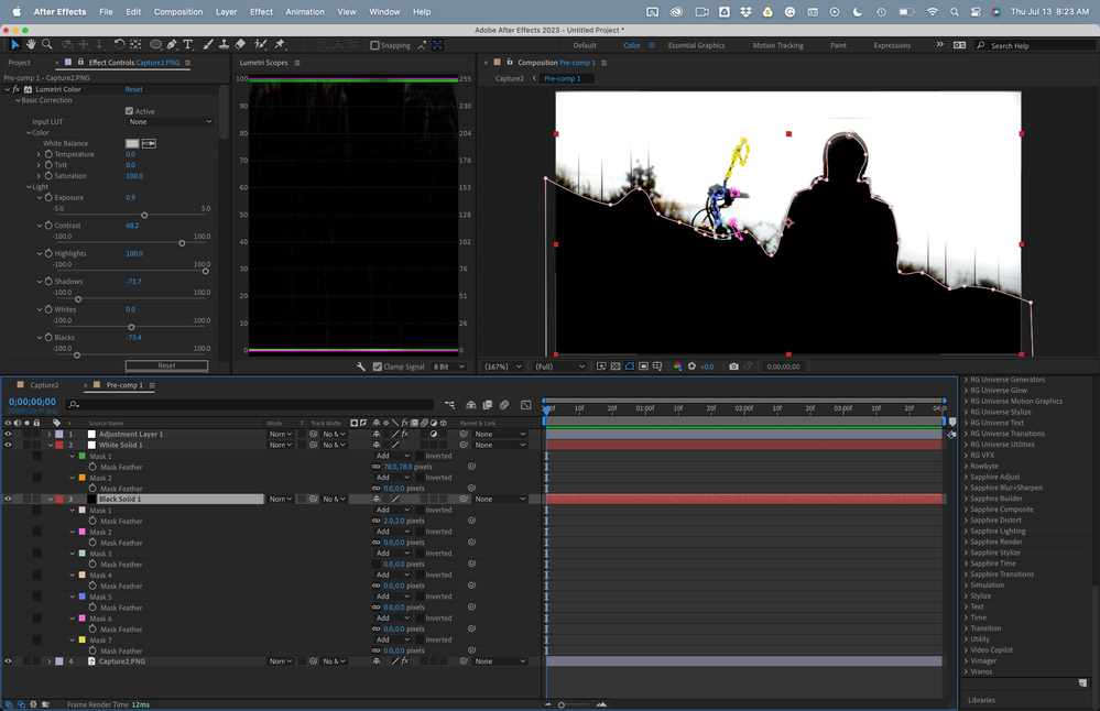

I downloaded one of your low-resolution screenshots and this Adobe Stock image to create a quick procedural matte and color correction workflow.
If I had the footage, the first thing I would do would be to motion stabilize the footage using Mocha AE so that the motorcycle does not move in the frame. I did not show that in the sample comp that you can download.
After Adding the footage to a comp, the first thing I did was apply some color correction to increase the contrast and give me some edges to work with. Then a Black solid was added, and the hand Rotoscope was completed to black out the foreground and the reflections on the motorcycle. Then I did the same thing with a white layer to clean up the sky and poke a hole in the mirror. I would have used Mocha AE to do the Roto if I had a movie instead of a still to work with. Rotobrush would be useless on this shot.
Now that I have a matte created, I drop the original footage and the replacement sky in the comp, pre-compose the layers sit took to make the Matte, and use the Pre-comp as a Luma Track Matte for the replacement sky. A bunch more fiddling with opacity, a master adjustment layer, some more masks, and I ended up with something like this.

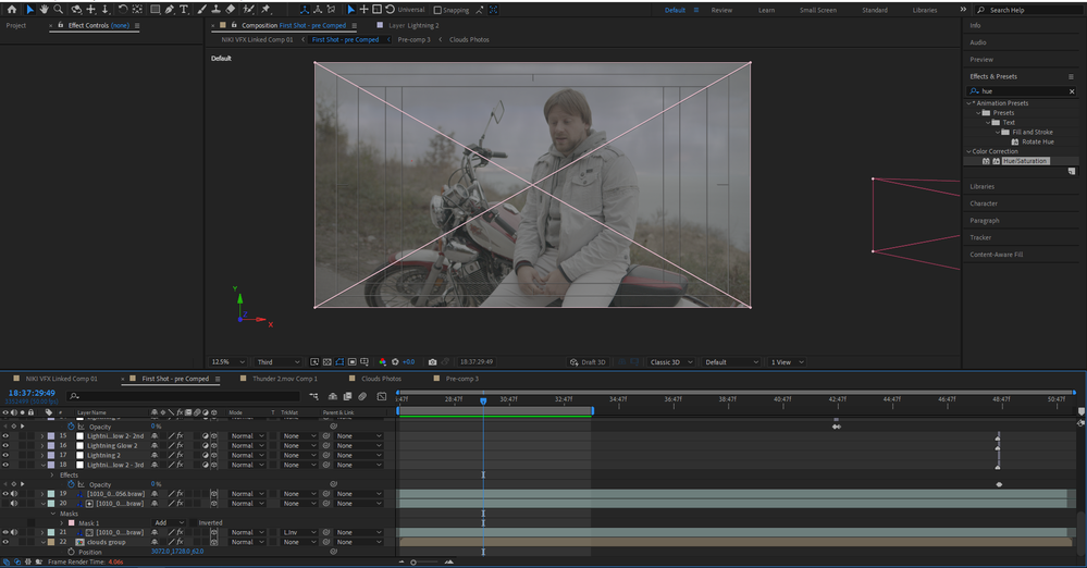

What aslo still puzzles me is that after camera tracking, and creating a null and a camera, and after having a contrast betweeen the foreground and background, if I replace the sky with a static photo with clouds and make it a 3D layer, things just don't work when it comes to the clouds moving along with the camera. If i replace the image with a footage of clouds, it seems to be working fine. Where could the problem be? I'm attaching a video again that displays a rough version of this with an image, instead of a footage.
Jul 14, 2023 Jul 14, 2023
The preview looks pretty good to me.

There would be no 3D layers because I would not use Camera Tracking for a Sky Replacement because there is no parallax in the sky. I'm not sure why you have 3D layers in your comp. If you used the Camera Tracker to add something else to the shot, you need a slightly different workflow.
