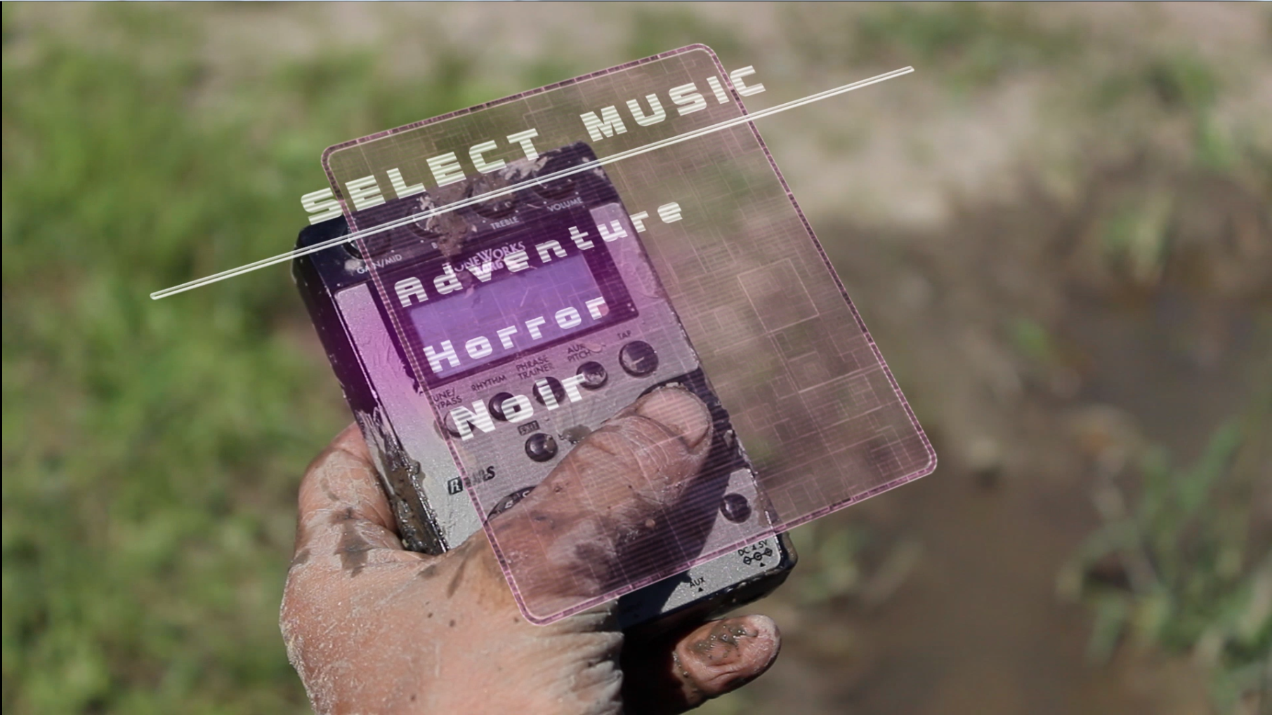

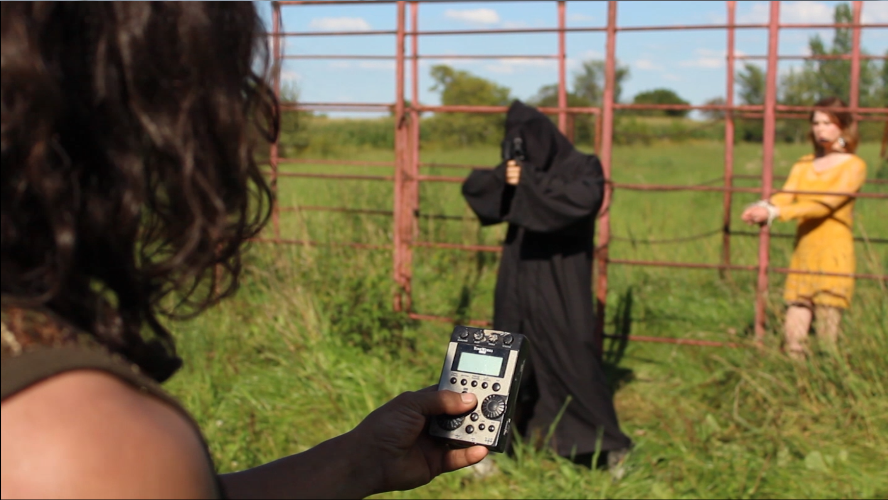

I'm trying to have a holographic screen hover over an object that my main character is holding. This happens in a couple of shots. I was able to pull it off in a couple of shots using simple planar tracking in mocha but the rotation is always a bit off and I need to correct manually way too often.
I am sure there is a way to track not only the position but the rotation of my object in 3D space as to simply get a rotation axis to which I could parent my hologram composition. I have attached a couple of screenshots for reference.

looks fine to me with this setup. make sure you get a track that sticks. in Ae 3D it and parent it to a 3D null and offset the Null in Z, scale a little, adjust maybe with position for the first part and you are good to go:

Like I said, as far as tracking with mocha I have no problem and the racking focus wasn't too much trouble, the problem is that mocha doesn't deal with any 3D data.
If I wanted to have the image skew perfectly on the device I wouldn't have any problems. What I would really like to be able to do is to have data for rotating an axis facing forward of the device and that allows me to move and rotate my hologram as a 3D object based on that plane that I'm tracking. Or is there an easier solution to get the same results that I'm missing?

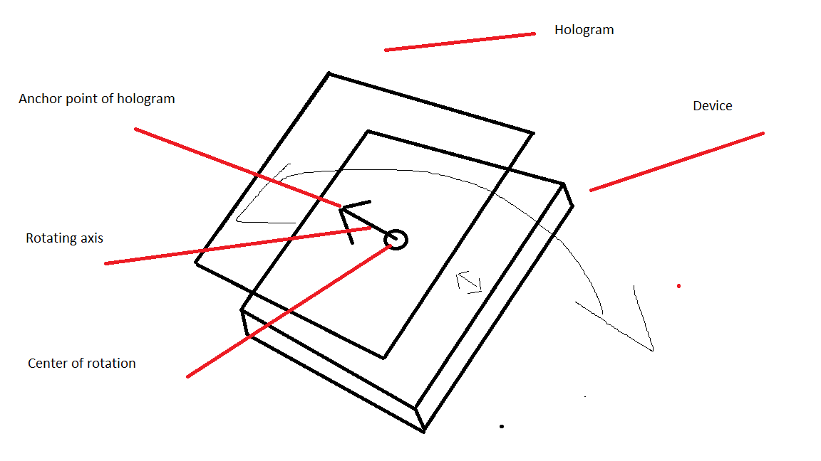

I appreciate the use of mocha as far as planar tracking goes and the video you included in your comment would be the perfect way to go about having my image displaying right on the device my character is holding. However what I am looking for is some distance in 3D space between the device and the hologram. As if it was hovering over it. Once again and it would be no problem if the device wasn't moving and rotating around in the hands of the said character.
However what I am looking for is some distance in 3D space between the device and the hologram. As if it was hovering over it. Once again and it would be no problem if the device wasn't moving and rotating around in the hands of the said character. Unless I'm missing something obvious I'm thinking that I need 3D space rotation data to parent my comp to.
Here is a graph what I'm looking for.

if this is a flat screen you need to move in parallax with the object, then after you track it accurately on the screen, try set as a 3D layer and push the Z position back. if your layer has keyframes then 3D it, parent to a 3D null and move the null back. it might give you the offset that you need. of course if we could see the shot we could be more helpful and walk you through it.

This is pretty much what I'm doing. The problem is that the z axis is in relation to the background and not to where the emitting device is facing. It works half the time but I need to compensate when it rotates too much and I'm trying to find a simpler way to go about it. I will upload some footage so you guys can see better.

Here's how it looks when I do a 4 corner pin and push back the z axis a bit. It looks okay but you can see how it rotates on it self instead of how it should. Is there a way I could get the perspective right without having to compensate manually every time?

can you upload a clean shot so we can work with it?
