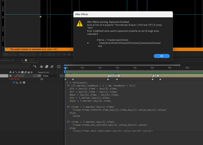

Hi Everyone,
I need help to refine this expression of triggering animation with layer markers.
I have animation of a text that starts with key 1 to key 2 and then this text transition to another text key 3 to key 4 and then text out key 5 to key 6.
The 2 texts layers are pre composed, and my expression is applied into the Time remapping with these 6 keys.
Basecaly, the expression works fine, just I'm getting expression error for this line
if (time < T.marker.key(1).time)
linear(time,inPoint.time,key(2).time,key(1).value,key(2).value)
else
Everytime, I move my timeline indecator before my marker.key(1). But the expression keeps working fine.
This is my expression:
T = thisLayer;
if ((T.marker.numKeys > 1 ) && (numKeys > 5)){
dIn = key(4).time - key(3).time;
dTr = key(2).time - key(1).time;
dOut = key(6).time - key(5).time;
eIn = T.marker.key(1).time;
eOut = T.marker.key(2).time;
else
value
if (time < T.marker.key(2).time)
linear(time,eIn,eIn+dIn,key(3).value,key(4).value)
else
linear(time,eOut,eOut+dOut,key(5).value,key(6).value);
}else
value;
Thank you for your help

Community Expert , May 15, 2024 May 15, 2024
In that case, I think it would be like this:
if ((marker.numKeys > 1 ) && (numKeys > 5)){
  dIn = key(2).time - key(1).time;
  dTr = key(4).time - key(3).time;
  eIn = marker.key(1).time;
  eOut = marker.key(2).time;
  if (time < eIn)
    linear(time,inPoint,inPoint+dIn,key(1).value,key(2).value)
  else if (time < eOut)
    linear(time,eIn,eIn+dTr,key(3).value,key(4).value)
  else
}else
  value;

Your branching in the conditional is wrong. The precedence is
if
else if
else
Also your code is sloppy. Even else statements require ( ). Fix your syntax and formatting and it should work correctly.
What is it supposed to do?
New Here ,
I have 3 animations In, transion and Out
The In can be always at the bigenning of the layer, first marker should trigger the transition and then the second marker should trigger the Out.
In your code, it looks like the transition happens before the In, is that correct?
New Here ,
The In animation can always starts at the inPoint of my layer (it doesn't need a trigger). transition should be triggered by marker.key(1) and then Out should be triggered by marker.key(2)
  if (time < eIn)
  else
}else
  value;
Working perfectly.
Thank you very much for your help, much appreciate it.
