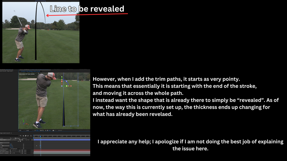

I am creating shot tracers for golf videos. This requires me to create a tapered stroke (so that the end of the line is thinner than the beginning).
This helps give the perception that the line is getting farther away.
However, when I apply Trim Paths to the line, it isn't just "revealing" the shape that is already there. It is actually changing in thickness a bit once it has already been created. It is a little bit hard to explain, so I will attach a screenshot.
Please let me know if you have any questions or if I can clarify anything.
The 7:15 mark in the link provided is a good example as well.
Although the animation looks decent, you can see how the thickness of what has already been revelaed changes a bit over time.

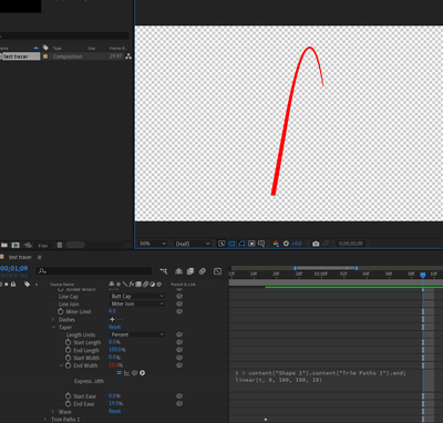

Hello, I wanted to circle back on this here. So this has definitely been a helpful solution, but I think there is one more thing that I am missing.
Is there a way to essentially pick a spot along the line where I want the taper to start, and then essentially from that point on, the width all the way to the end would remain the same? I am trying to replicate what is shown below, but I am unable to with this expression and the easing commands.
As you can see, in the stroke above, the line does not get pointy at any point. Once this line completes all the way to the ground, it would have that same thickness level.
As you can see in my setup below, trying to get the end to be thinner has an impact on the entire stroke. It makes all of it come off as pointy, as opposed to hitting a certain spot and staying at that new width like the one above.
