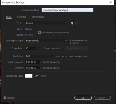

I was wondering if someone could help me figure out what is going wrong when i am rendering out my AE project. I have made a composition with the idea that it will be for an instagram story at 9:16 ratio. The composition settings have been set up so that they match this 9:16 ratio and the AE viewport seems to reflect this ratio as well.

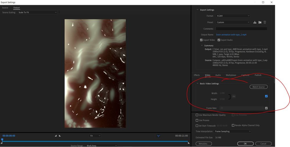

when i start to render it out using the media encoder i chose the following settings as they seem to matc the ratio seen in the composition settings in AE.

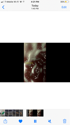

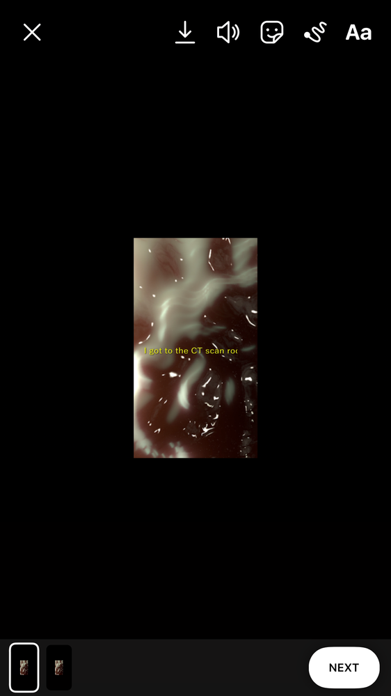

thank you very much for your reply! I have tried saving on my phone and doing the instagram story steps as you suggested, but i'm still getting a weird version of the video. when i see it on my phone it still appears as a vertical video with two very thick black borders and when i see it in my instagram as if i were uploading it as a story its very scaled down surrounded by black borders.
seen on iphone:

seeon on instagram story:

Apparently it is coming out in 16:9. So after adjusting to Match Sourse go down a bit and in the video tab make sure it is 1080 width and 1920 height. If it is not, turn off the aspect ratio lock check pin and adjust it manually.
Byron.

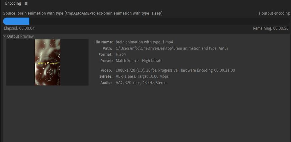

So i've cheked the settings in the video tabl and the media encoder settings are correctly set to the 1080 width x 1920 height correct ratio. This is so bizarre!

I downloaded that file and the first time i rendered out the comp the frame size were very small. Then i noticed that the Resolution in the Composition panel were set to Quarter, so i changed it to Full and then the renders came out as 1080x1920.
But if i just close the project and reopen it and try to reproduce it it always work, so it´s odd. So try to change that setting.
