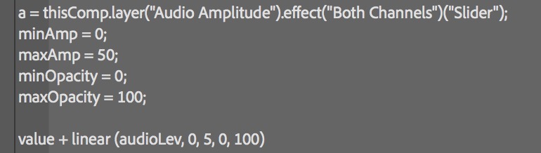

New Here ,
Sep 22, 2018 Sep 22, 2018
Thank you!
when I plug it in like this, I get the error message though! did I do something wrong?
LEGEND ,
Sep 23, 2018 Sep 23, 2018
Rename variable a to audioLev.

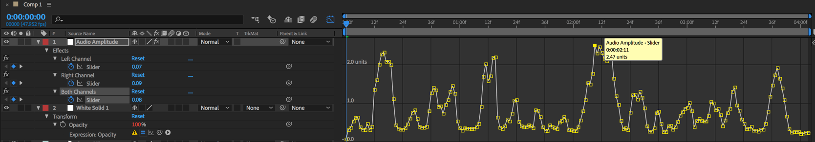

"t" would be the value you are getting from the Both Channels keyframes that were generated when you used the keyframe assistant to analyze the audio. "tMin" and "tMax" are the minimum and maximum values of the keyframes. These are very easy to see if you just open up the Graph Editor and you look at the value curve. That's how you decide what values to use for the variables.
This is the graph editor of a sample audio file. It is easy to see what values you have to work with by simply hovering over a keyframe. In this example, the audio ranges from a high of 2.5 units:
to an average low of about .35:
I want my new values to start as soon as the audio starts to rise from the average low point and end when I get about 80% of the way to the loudest values so I make note of the high and low values.

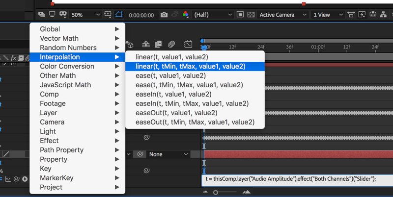

It is a good idea to do as little typing as possible writing expressions because it eliminates the possibility of typo's. Start the expression by first defining the variable by typing "t = " and then using the pickwhip to point to the Both Channels parameter. Now the value of for "t" is defined.
An apostrophe and a return end the definition of the variable so all that is left is to load the full linear method from the Interpolation menu;
and fill in some values.
