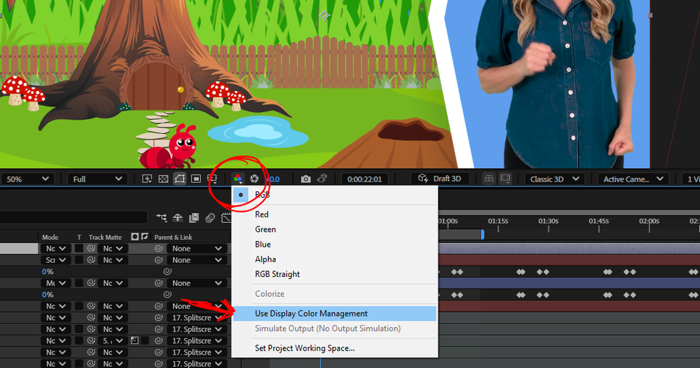

In After Effects, there is a setting under the Color Management Settings called "Use Display Color Management." After finding this, it immediately became clear that this was what was causing my issue. In my scene, this was originally checked on, but when I turned it off, my project looked exactly like my AME export. AME does not have this setting, so it was reading the AE scene exactly as is and not applying that color correction.
The Solution:
Turn off "Use Display Color Management"

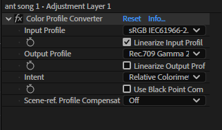

Add the Color Profile Converter Effect to your Adjustment Layer
Set the Input Profile to whatever your current color settings are in your project
Set the Output Profile to whatever gets your scene to look how it was when "Use Display Color Management" was turned on. (in my case, I chose Rec709 Gamma 2.1 If you're not working in this already, this is the setting I recommend)
Save your file, and when you send it to AME, it should look exactly the same.
The Solution:
