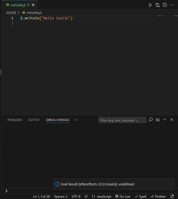

Hi, what exactly did you do?
My configuration looks like this and it doesn't work

Oct 25, 2024 Oct 25, 2024
Are you looking in the Debug Console?
Contributor ,
Oct 26, 2024 Oct 26, 2024
Yes, there's nothing there.

Try this:
Contributor ,
Oct 30, 2024 Oct 30, 2024
In my case it doesn't work.
upd.
After reinstalling VS Code works.
Thank you, useful information
Advocate ,
I don't think so. 🤔
Look at your screenshot
You probably simply evaluate the script
My window:
