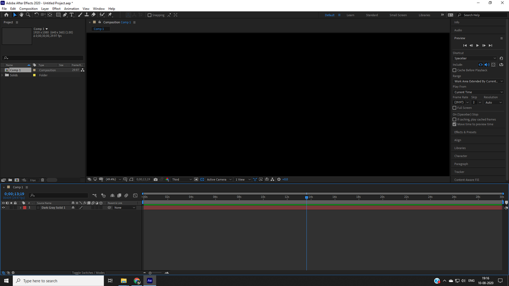

Why This is happening? Please give me a solution.Why This is happening? Please give me a solution.

after effects compositing preview is black
compositing preview is blackcompositing preview is black
