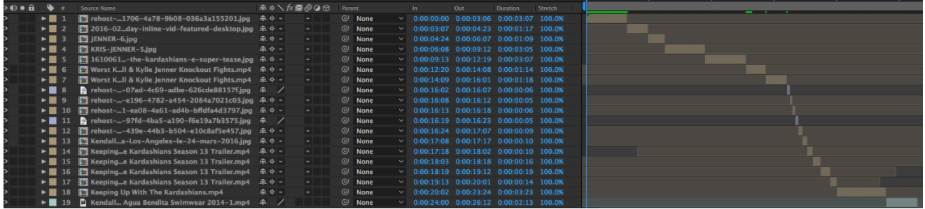

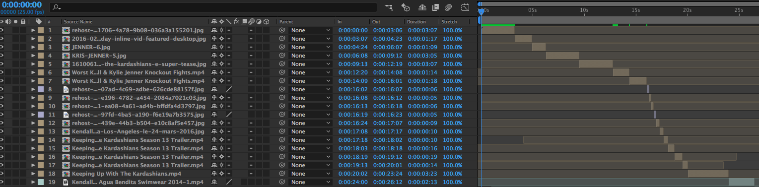

Community Beginner ,
May 08, 2017 May 08, 2017
Is this not the correct way to Dynamic Link your timeline from Premiere Pro to After Effects? I mean it opens AE and the timeline matches my PP timeline with all the clips layered and correct length etc, but they are nearly all Pre-Comps... some aren't for some reason.
LEGEND ,
well you could do that yes. but replace with after effects composition is usually for single clips, not whole editing sequence.
You are quite wrong in your assumptions of my work flow Roei, in fact, everything you suggest is in actual fact how I work. It would be insane to edit in AE. I edit in PP, and then, if I need to do any effect work, which is the case here, I copy my original clips onto another layer, and then I Dynamic Link that to go to AE, do my effects work and as you are aware, it is then automatically in situ in PP.
I needed to do work on a number of concurrent clips, not one clip, so there is no problem doing it the way I have, and have been doing it this way for years. My question was not about that, so you should consider my question as opposed to telling me how to use dynamic link.
My question was why were my layers coming in as pre-comps, and you hit the nail on the head there. Yes, it was because I did set "Scale to Frame Size". That has solved my problem, thank you.
