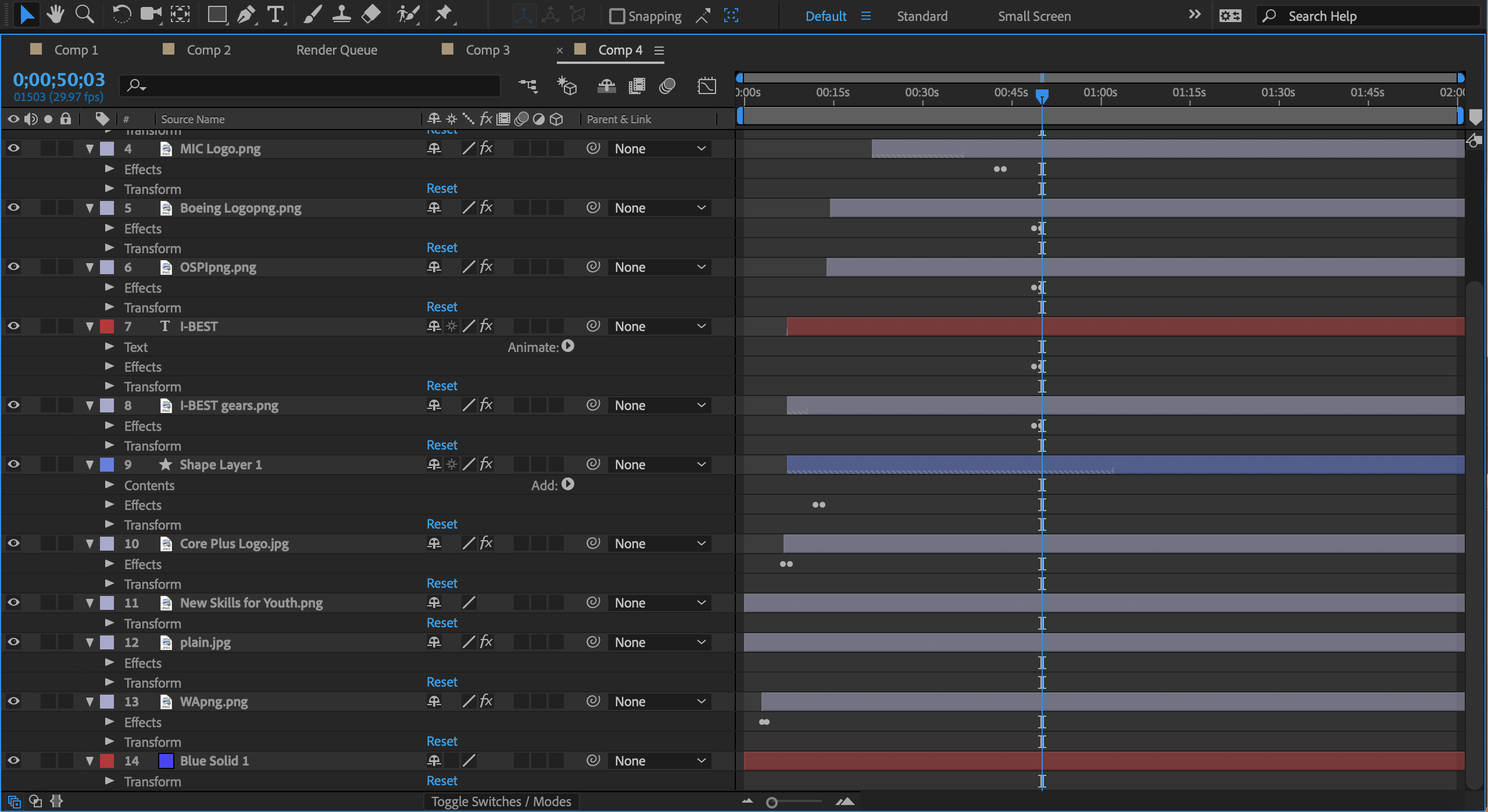

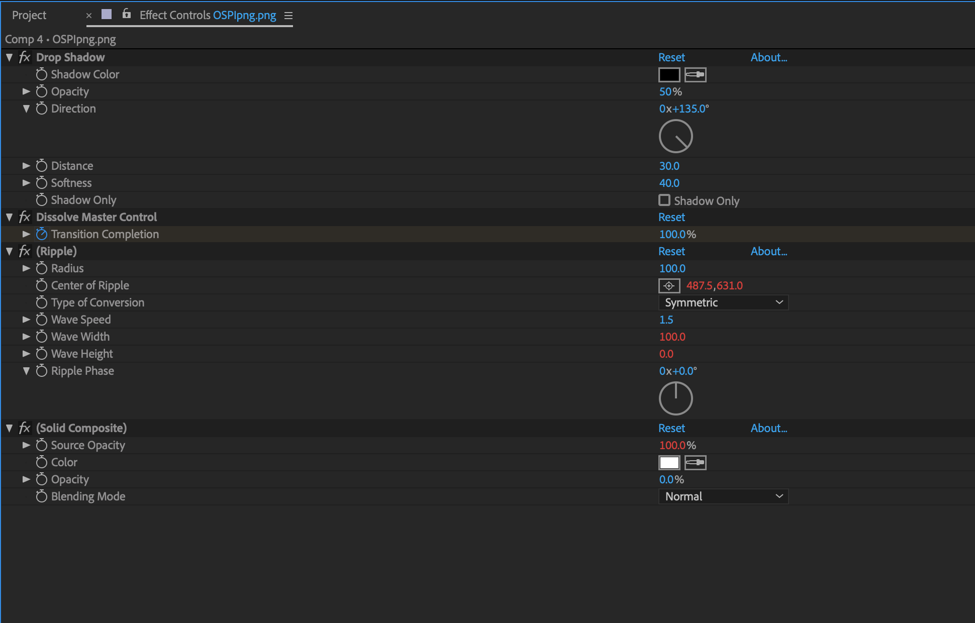

Update: I discovered that part of the problem is that I wasn't understanding the timing of the animations and some of the animations were set in the layer at a time before the layer was set to appear. Now that I adjusted those, things are better. But it still gets slower and slower with the preview once I get passed 5 or 6 layers each with an animation. It ends up rendering just fine. It's just the previewing that slows really quickly. Is there anyway to set up a couple layers with animations and have it process that much before adding more? Or anyway to help it preview more efficiently. Below is my timeline with the layers opened up and also the effects panel. The effect shown below is the same one on almost all the layers.

Step 1: Check your background image. If it is not at 100% scale at some point in the timeline then open it up in Photoshop and resize it so that it does. Every pixel you reposition in the comp needs to be recalculated for every frame. If the background image is static then crop it and size it to match the comp size.
Step 2: Make sure the layers are trimmed. If they are not visible, set in and out points.
The Dissolve Ripple Animation Preset is not a very quick transition to render and if the animations are stacked on top of each other the time required to render the frames goes up exponentially.
If all else fails, break the comp up into 10-second sections and then render them and cut them together in an NLE.
I have not seen your design but two minutes of the same background with smaller pictures fading in and out at different times may not be the most effective way to visually tell your story. Sometimes a little more creativity can speed up the entire production process.
