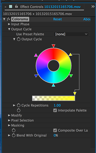

I'm on a later version of AE but I cannot reproduce your bug. When you select the yellow colored triangle do you get the connector to the opacity slider?
If the connector is still tied to the red triangle then you do not have the yellow triangle selected. The triangles on both ends of the connector will be the same color.
Your CS6 should be up to date. I don't remember if there were bugs in early builds of that version.
