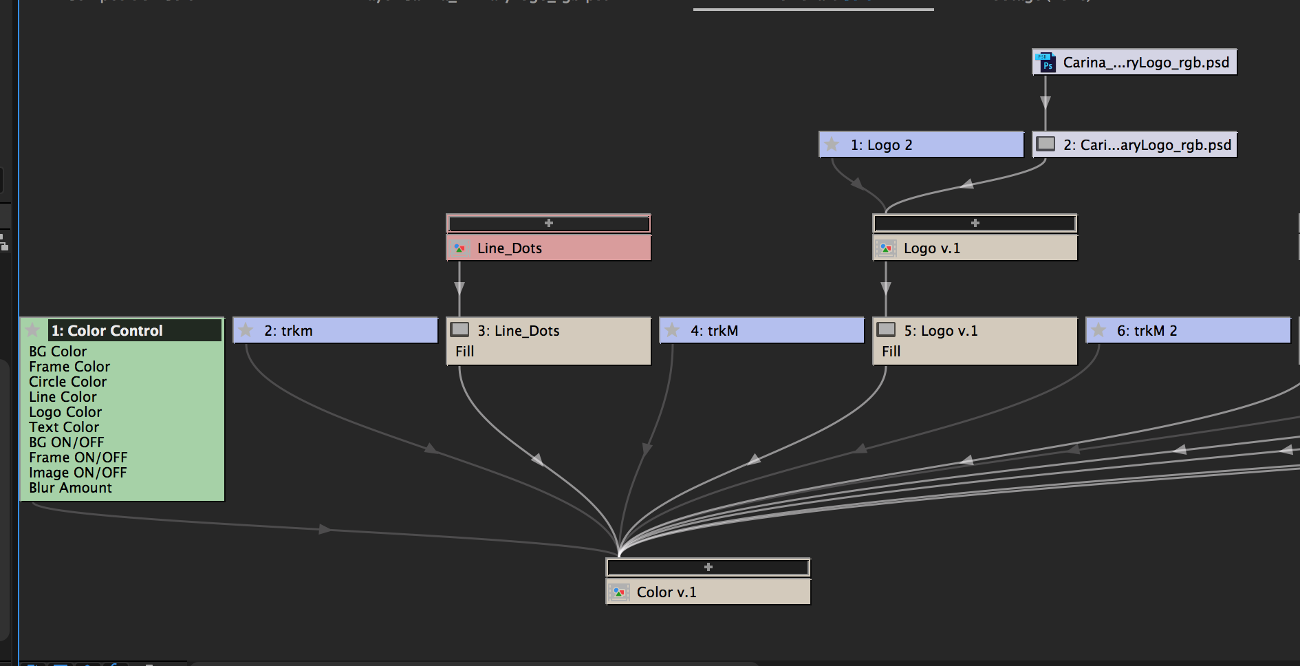

If you enable the flowchart view, it might help you find the offending precomp. Basically, whatever comp you put your logo into is nested in another comp somewhere along the way that puts its own color on it.

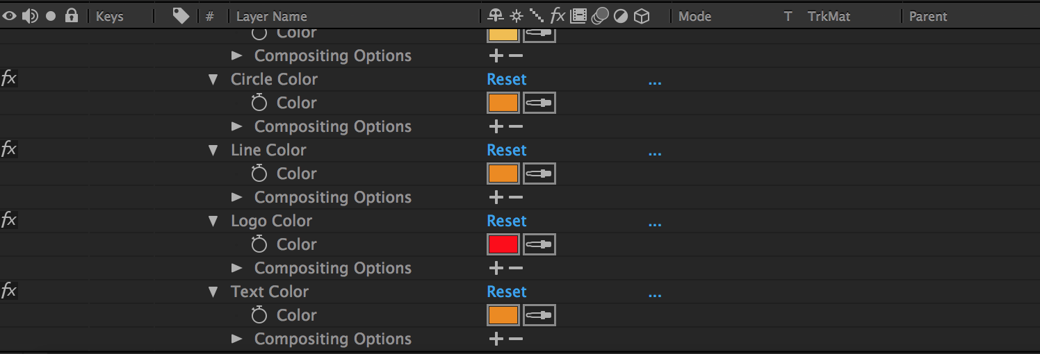

Thank you. I can see where the logo is receiving the fill color. I can also change the fill color (it was green, now I reset it to red). But I cannot seem to turn the fill color off completely...
I was expecting some kind of on/off toggle. There is an on/off toggle for background color but not logo color.
Screenshots attached. "Logo v.1" is being modified by "Logo Color" under "Color Control" Screen Shot 2017-02-21 at 10.15.41 PM.pngScreen Shot 2017-02-21 at 10.21.27 PM.png

That color control layer is driving a fill effect on your logo composition somewhere else in the hierarchy. All you have to do is find that logo layer with the fill effect and turn the fill effect off.
From that flowchart, it looks like it's the Logo v.1 comp nested inside the Color v.1 comp. So, inside Color v.1, find the logo comp and turn off the Fill effect.

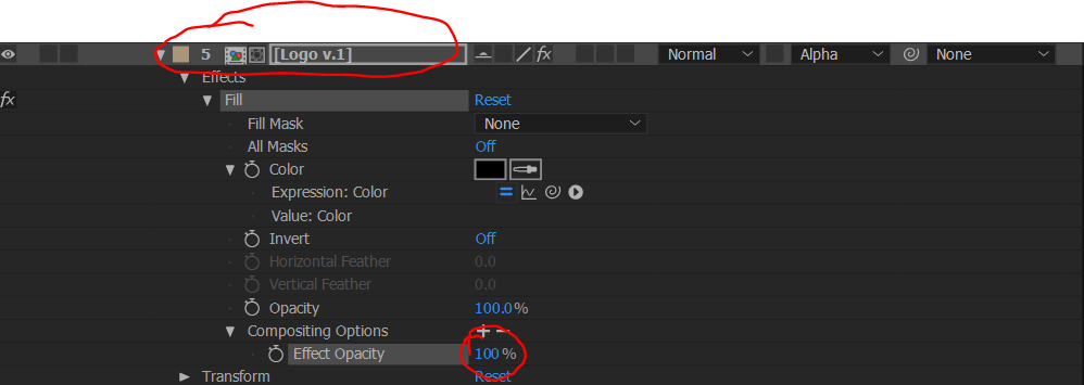

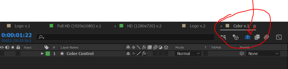

Hi everyone, I'm a novice to After Effects so Motion Array's free templates have been helpful as I learn about the program. That said, I struggled with this template as well, but I think I figured out this issue.
So from the Color v.1 Composition, you want to toggle the 'Shy' switch off so you can view the hidden layers. One of those layers is the [Logo v.1]. First unlock this layer and then you'll be able to expand it's submenu. From there, you'll see Compositing Options >> Effect Opacity. Change this from 100% to 0% and your original logo color should now be visible.
