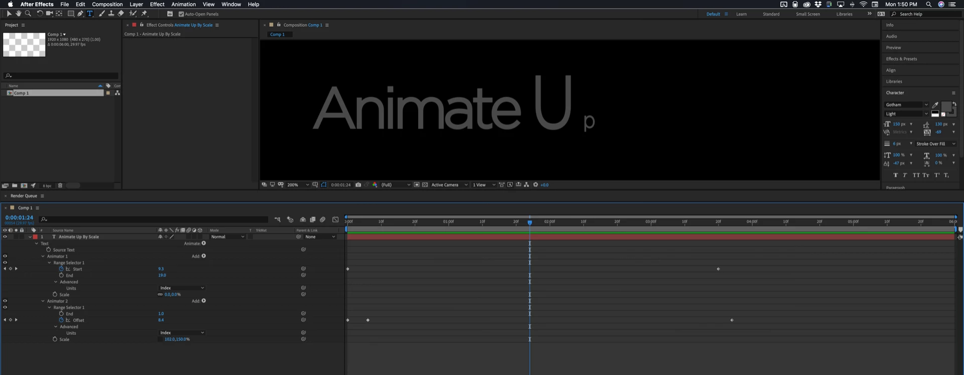

You are probably making this much more difficult than it needs to be.
Start by adding a scale animator, change the Units to Index under the Advanced settings, then duplicate your text animator in the timeline. Set Text Animator 2 so that the Range Selector end is at 1 then adjust the scale so that the first letter only is at its maximum size. Change the offset to -1 and the first character should return to normal.
Now set Text Animator 1 so that the Start range selector is at 0 and enable keyframes, change the scale to 0,0 so all the text disappears, then move down the timeline and set the Start range selector to match the End Range selector so that all the characters are full size. The Characters should now animate on buy scaling up.
Here comes the trick. Enable Keyframes on the Offset property of Animator 2 and move down the timeline a couple of frames farther than the keyframe you set for Animator 1>Range Selector>Start and set the offset to the number of characters in your text layer.
The last step is adjusting the position of the last offset animator so that the timing is correct. That is all there is to it. You just have to get the stacking order right. It would look something like this:
