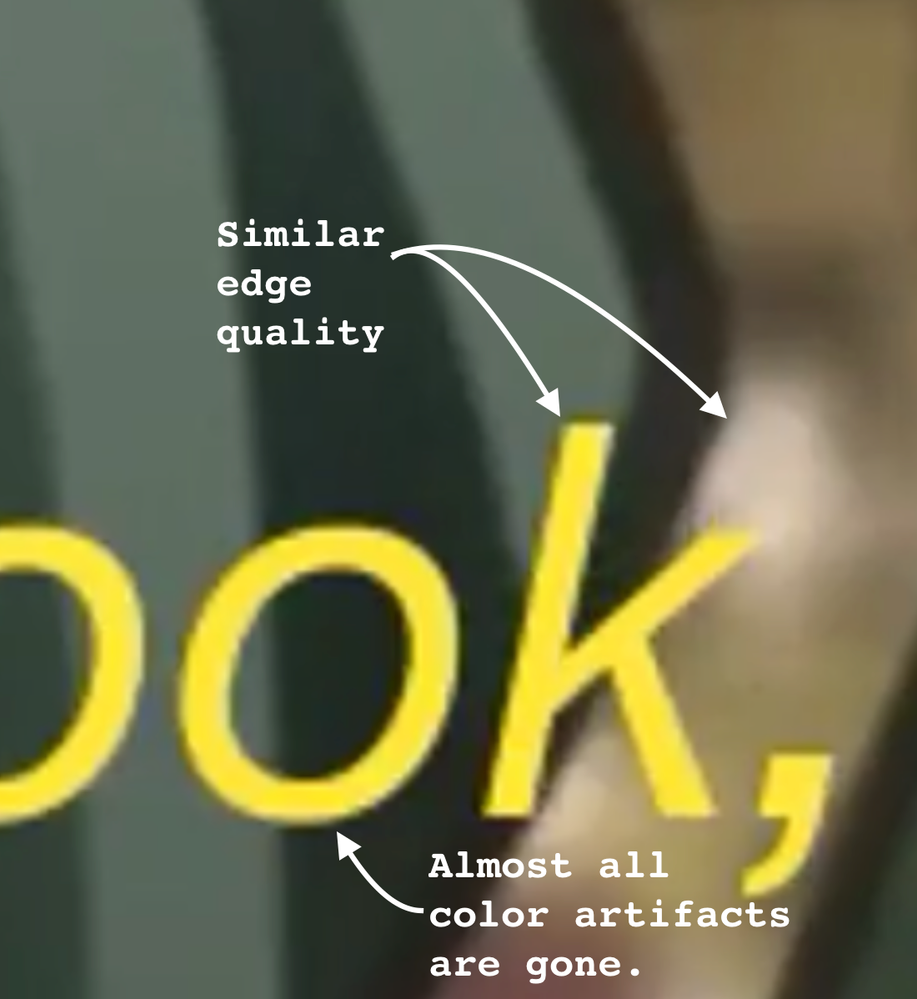

You are always going to get pixels and to get the edges to look the best the edges will be anti-aliased. There is no way around that. You will never get the text to look as sharp as it does on your phone or on a web page because it is going to be pixels, especially when you enlarge the image. The closeup screenshot looks like it is at least 400%. Your screenshots look just fine to me.
Your composition settings should be standard HD or Standard 4K dimensions. They should not match the specific frame size (resolution) of your phone. A mobile device and a web page will always scale the video to fit the screen and it will either add black to the edges or crop the video to fill the screen. If the video frame size does not match a standard screen ratio and size, the media player will scale it so that it does and that will degrade the image.
