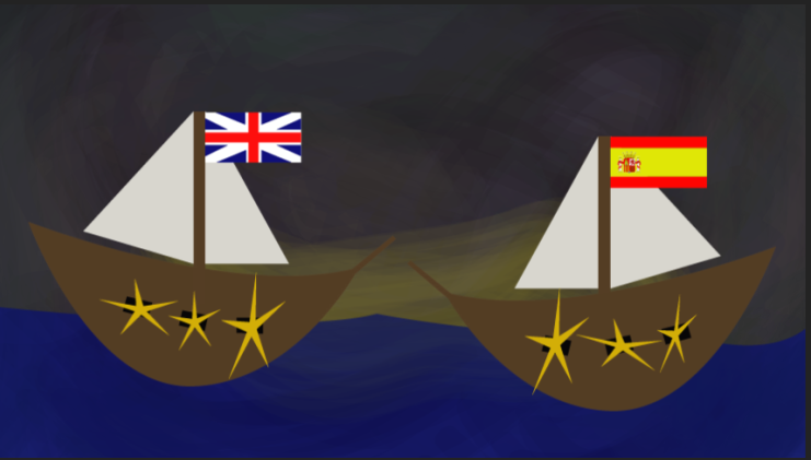

I have the newest version of Adobe After Effects, and for some odd reason, the contents section of a layer is not showing up. I want to add a wiggle effect to my water layer. I imported it from Adobe Illustrator
Everything in here is a layer. I want to make the flags wiggle and perhaps the water unless I can figure out another way to make it look water-like. Anyways, I have attempted to bring up the contents section of the layer options, my instructor wasn't able to find it herself.
I don't know if I'm providing enough details, I'm not entirely sure what details are needed. Let me know what else you need to know.

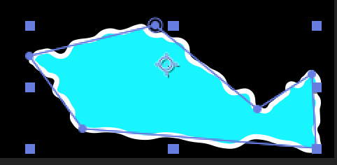

Wiggle path works best on stroked paths, not so predictable on filled shapes and it may not give you what you want on the water layer because it only effects the edges.
If there is a texture or gradient applied to your water layer it may not come through when you convert the layer to a shape or you may end up with a bunch of separate shape layers.
I think what you really want is some kind of distortion. Maybe even a pre-composed Fractal noise layer used as a displacement map to make the water look like it's moving.
