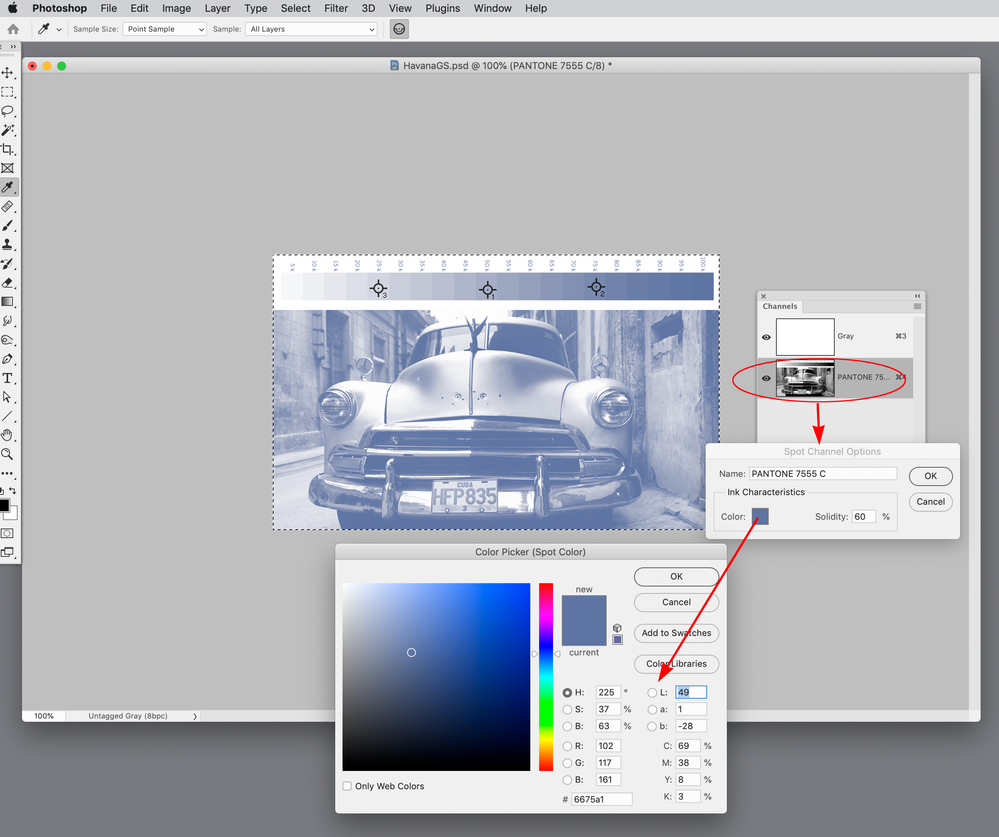

Hi @DebbieBerne , How is your Photoshop Spot color setup? Is it a Monotone or a Spot Channel? Are you saving the file as a .PSD?
Can you show screen captures of your setup as I’m showing below or share the file?
Monotone:
Spot Channel:

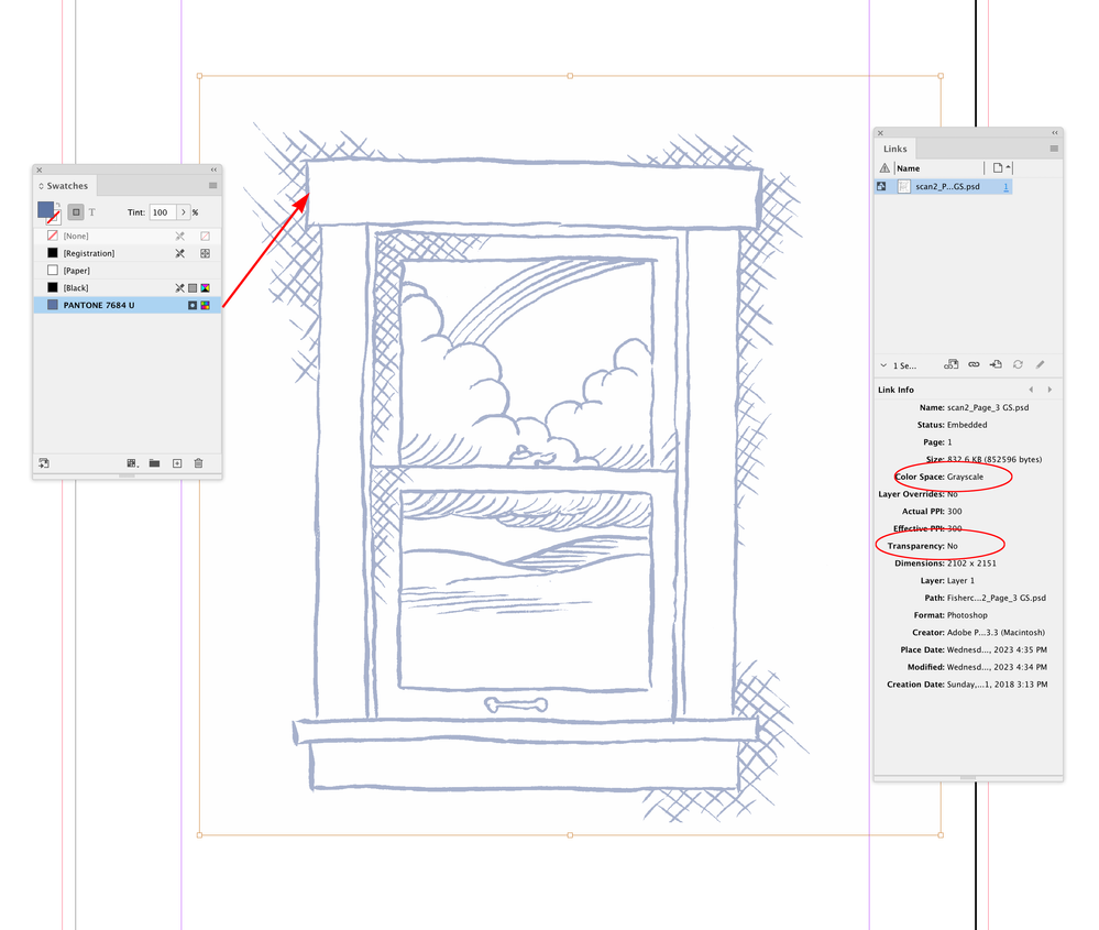

maybe I see . . . it's in grayscale not monotone. is that it?
Copy link to clipboard
Copied
Also, I’m not sure you need to set the Spot color in Photoshop, a flattened Grayscale image can have a spot color applied in InDesign.
See the attached .idml file.

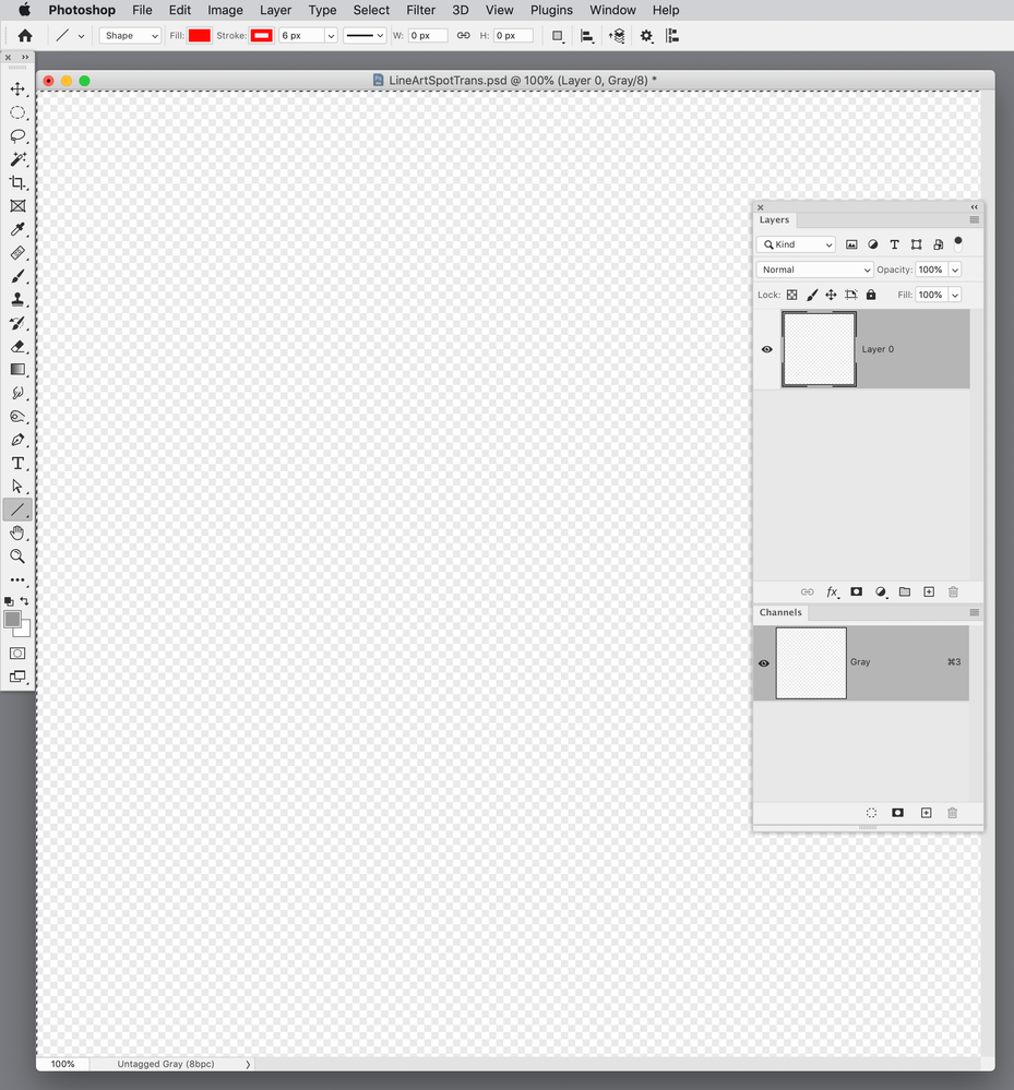

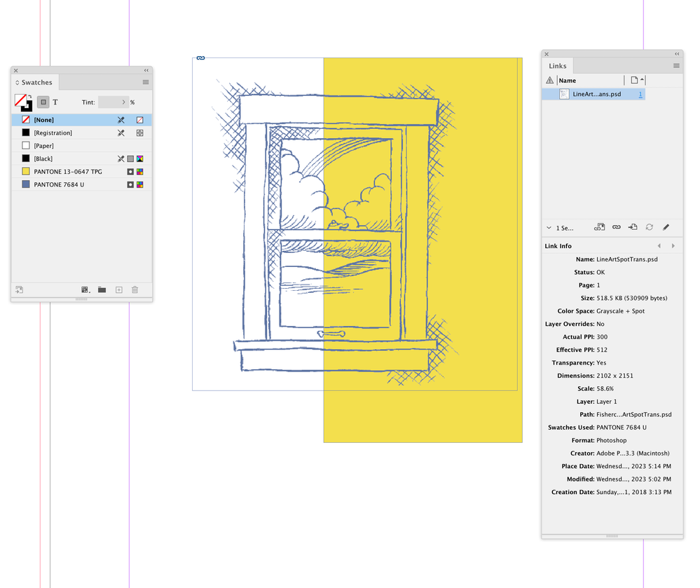

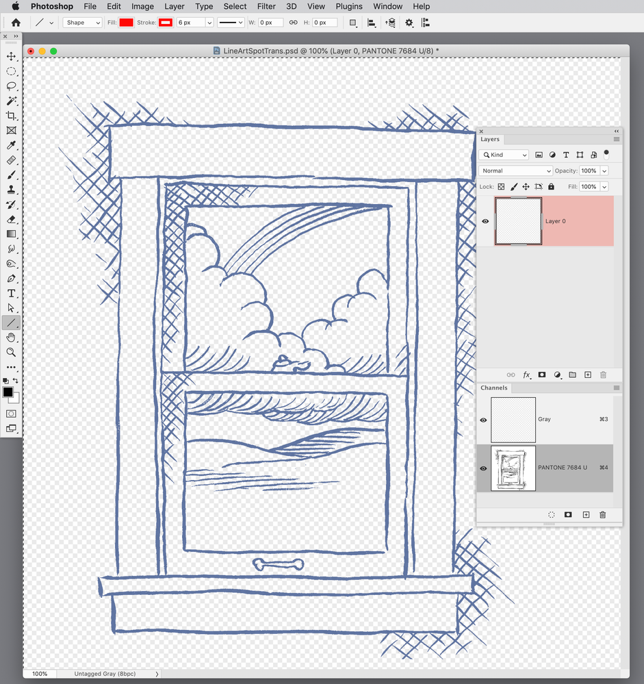

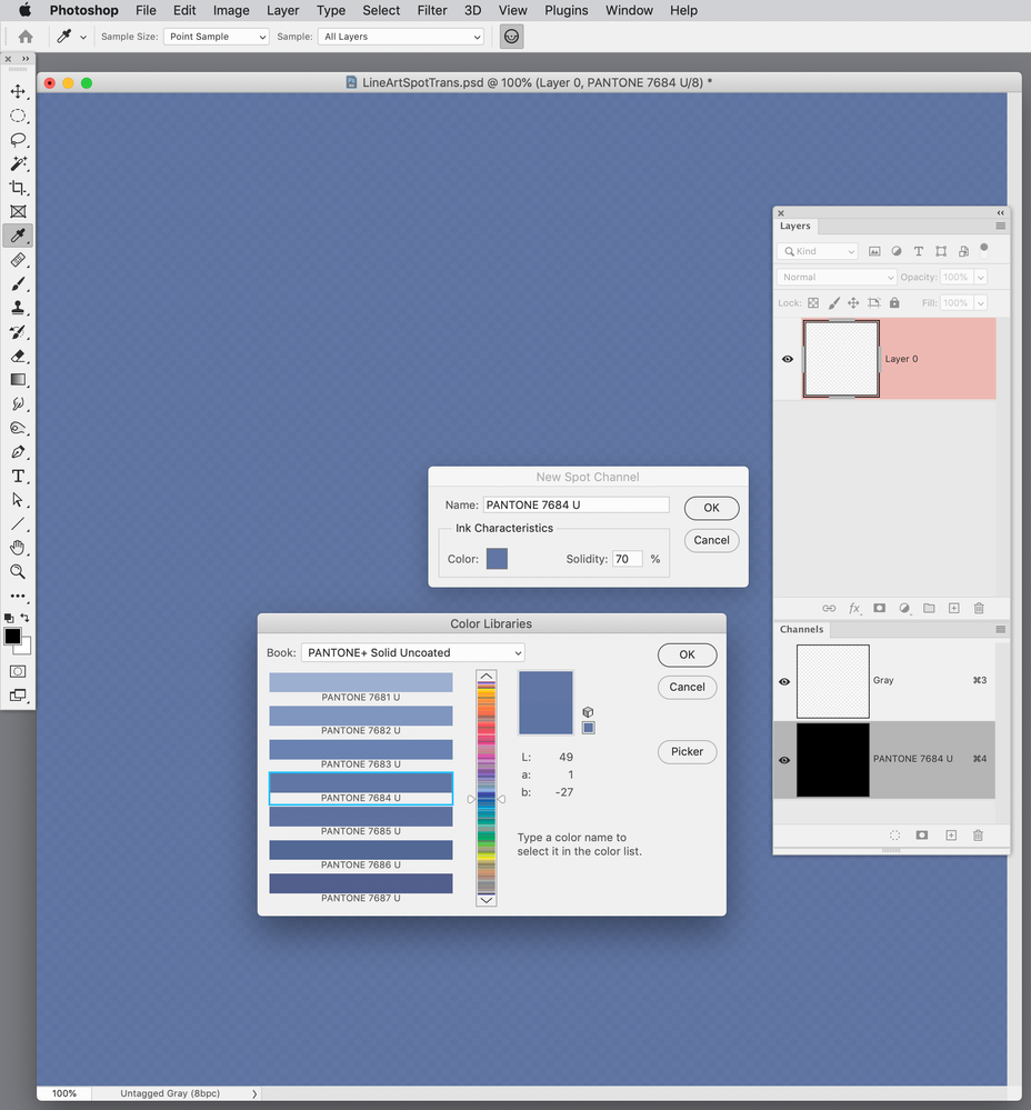

If you need transparency use a Grayscale with a Spot Channel and the Gray Channel empty and transparent.
A transparent Grayscale:
Add a new blank Spot Channel with the needed Pantone Color set as the Ink:
Select the Spot Channel in the Channels panel and paste the artwork into that channel—leave the Gray Channel empty but visible:
See attached

yes, got it. my monotone is transparent as well. But if I had, say, two spot colors (in this kind of line art) then I would want to use channels instead. Much appreciated!

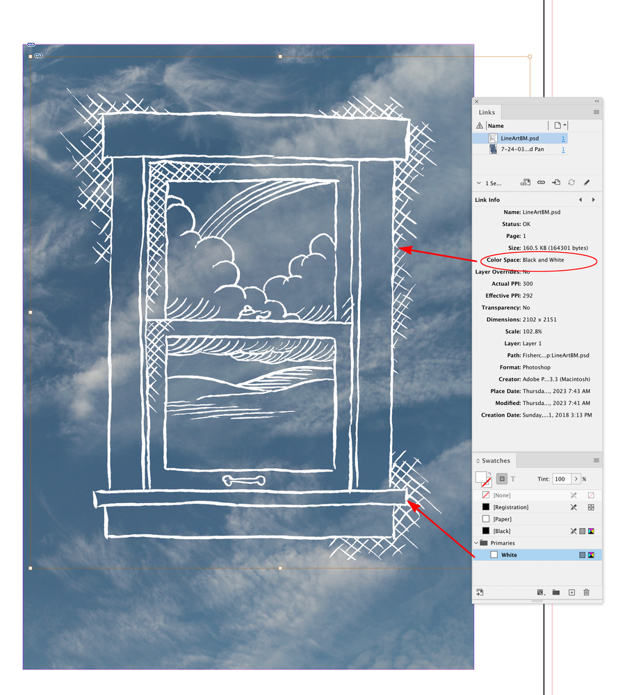

One other option for transparency would be a Bitmap (Black and White) mode. A Bitmap’s white pixels are effectively transparent in InDesign, and would work when the art has no gray values. Here the container frame is set to [None] and the art is set to White:
