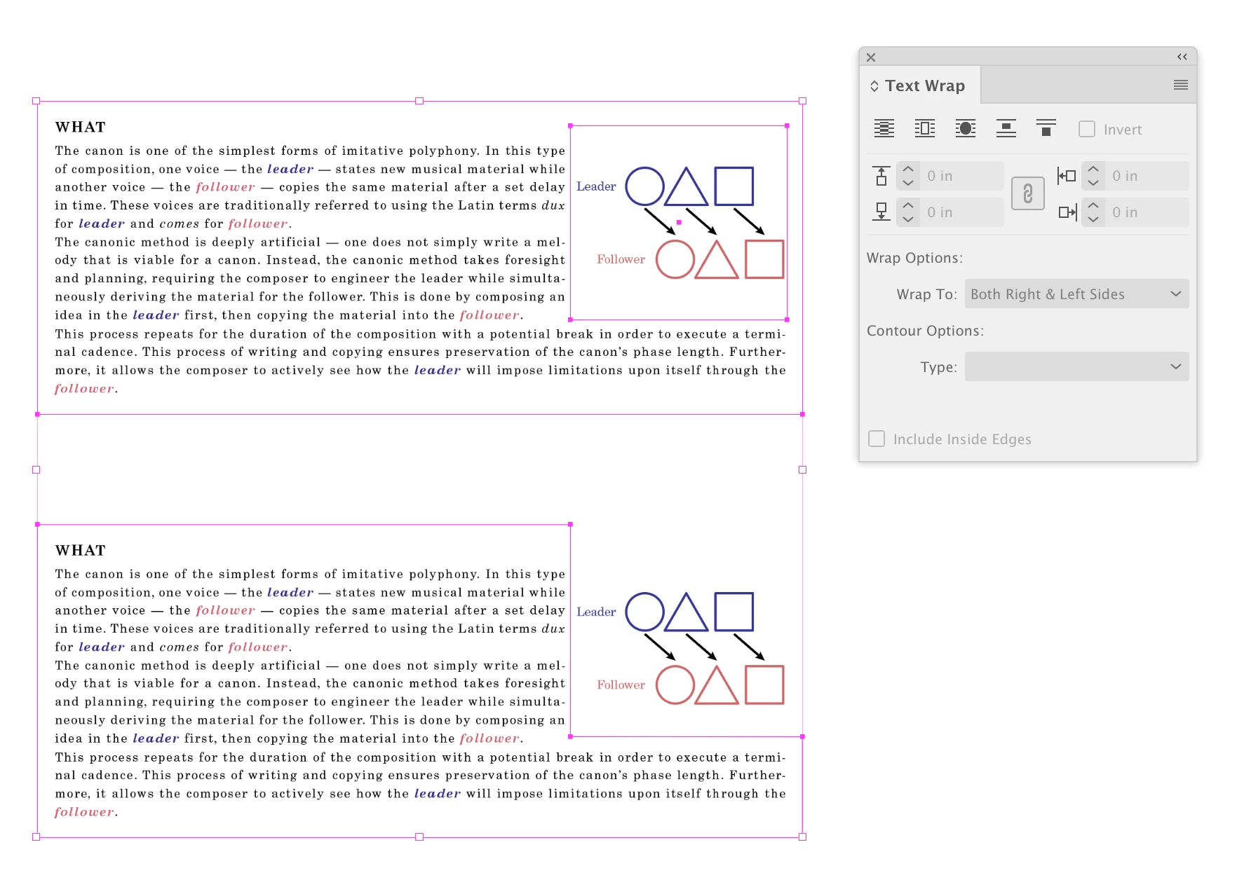

I would like to know if the behaviour shown in the attached picture (text flowing below a picture or a picture making text reflow on its own) is possible while using a single text frame.

解決に役立った回答 Luke Jennings3
You can add text wrap to the placed object (top screen shot) or if the objects are pasted vector objects, you can create an invisible rectangle and apply text wrap to that. Another less common method is to add anchor points to the text frame to change its shape (bottom screen shot).
Inélsòre作成者
August 14, 2020
This is just amazing!
Oh so much power and possibilities! 🙂
Thank you!

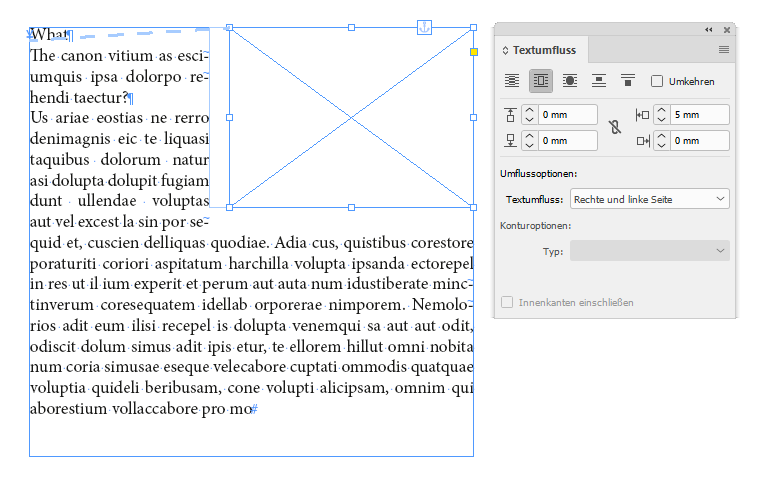

Hi Inélsòre,
can be done. You need one single paragraph for the "What" text.
You anchor the frame with the graphic in the first insertion point of that paragraph and give the frame a text wrap.
From my German InDesign 2020:
More info in InDesign's help system:
https://helpx.adobe.com/indesign/using/anchored-objects.html
https://helpx.adobe.com/indesign/using/text-wrap.html

Inélsòre作成者
August 14, 2020
I tried both the suggested approaches.
The text wrap seems the easier of the two but if I do not group the text and the graphic frames then they will not move together.
Is there any preference among users as they more or less achieve the same results, again, with the anchoring being less flexible to drags but more to options in the dialog.?
