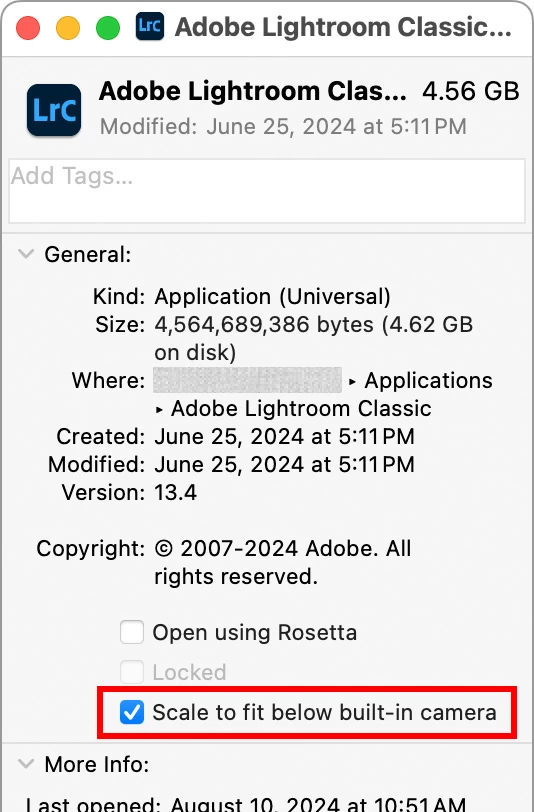

Happy New Year all! Curious, anyone else running into an issue where Lightroom isn't using all the screen real estate on the new 14" M1Max MacBook Pro? It's super weird, I'll be in any other program and everythign is fine, but when I select Lightroom it shrinks the part of the screen it uses and the 'digital bezel' around it increases. Pic attached showing difference from desktop to Lightroom. I've tried all screen options from default to scaled. Think I checked all options in Lightroom. Anywho...figured I'd give it a shot here and see if anyone else had that cosmic weirdness and if so, how you fixed it.
For the new MacBook Pros with a menu bar notch for the camera, there is probably not an option in Lightroom Classic that you will find that will change this.
What will probably change this is an option in macOS itself. For the notch Macs, macOS offers a new option called “Scale to fit below built-in camera.” You will find this by switching to the Mac Finder desktop, select

What you're seeing is normal for the 2021 14/16 inch MacBook Pros. The area either side of the notch can only be used by app or OS for menus.  However, Lightroom has an option that displays the app UI using all of the screen area below the menu/camera strip. This can be found under the Window > Screen Mode menu options as shown in below screenshot.

Oh cool! Thanks for that Ian! That worked (to an extent...). So when I first switched it using your recommendation, it looked great, I worked on some images, was excited, did the thing, but when I went to use the 'L' button (lights out mode) to dim the area around the image to check my progress, it reverted to just using the center part of the screen again, even on the left and right sides of the screen, and wouldn't go back to using the full screen again until I quit and relaunched LR. Here's screenshots of the progression from one mode to another and then back to filmstrip/develop mode. You'll see how the whole usable screen area shrunk from the top photo to the bottom photo with the lights out modes in between. I feel like there might be a bug or somethign with the lights out mode on the new screens.
What will probably change this is an option in macOS itself. For the notch Macs, macOS offers a new option called “Scale to fit below built-in camera.” You will find this by switching to the Mac Finder desktop, selecting the Lightroom Classic application icon (not the folder), choosing File > Get Info, and changing the setting “Scale to fit below built-in camera.”
When the option is on, a Mac application will act like it always has on older Mac laptops: It will stay below the camera (notch), so you will always see all of the menu bar. When the option is off, a Mac application will extend up to use all of the screen area available on the M1 Pro/Max MacBook Pro, but then the notch must be visible.
If the option is enabled for Lightroom Classic, you can get the effects you’ve seen: The area appears to change as you go in and out of full screen/Lights Out, and the available screen area seems to shrink or grow as you switch among applications that have that option set differently.
If the option is disabled for Lightroom Classic, it will use as much screen area as it can, but that means you will see a notch when Lightroom Classic is full screen.
Try it both ways and decide whether you like using Lightroom Classic better with the option enabled or disabled.

Ahhhhh!! That's exactly what I was looking for. Thanks so much Conrad. It was already checked and once I unchecked it and relaunched LR, it now uses all the real estate. The notch really doesn't bother me, so this is perfect. I appreciate that. Didn't know that checkbox existed.

I don't understand the bit about going to mac finder desktop,selecting the Lightroom icon (not file). I pressed Finder icon on my toolbar, then went to applications and clicked on LR icon but all that does is open up LR again. What am I missing?

You need to right-mouse click on the 'Ligtroom Classic' application icon (i.e. the same one you double click to launch the application), then choose 'Get Info' from the context menu.
If Lightroom Classic opens, then it was not clicked, it was double-clicked. Try again, but this time, just click once to select (not open) the application icon, then follow the steps I wrote and showed in my earlier post above: Choose File > Get Info, and that Info window has the option in it.
(You can also open Get Info by right-clicking the application icon, if your Mac is set up that way. A lot of people don’t enable right-click on their Macs, so I send them to the menu command first.)

Thank you for this! So initially I followed all your instructions and unchecked the box, but every time I opened lightroom and tried to full screen, it still sat beneath the bezel.  I thought I had to restart my M1 Macbook Pro and I did... but still nothing happened.
So as I was about to lose my mind, I found the additional solution: Step 2: After reopening lightroom, manually enter full screen by clicking CMD + SHIFT + F
After doing the full screen shortcut, the program will enter full screen mode and the notch won't be an issue anymore. Wooooo! So happy. haha. Thanks for your help

@Miraflor98 wrote:
So as I was about to lose my mind, I found the additional solution: After reopening lightroom, manually enter full screen by clicking CMD + SHIFT + F
Just a fun fact that might explain the difference sometimes:
Lightroom Classic supports two different full screen modes.
Lightroom Classic has its own full screen mode, which you go in and out of by choosing one of the Window > Screen Mode commands or pressing its F and Shift-F keyboard shortcuts. This is independent of the OS full screen modes in macOS or Windows.
Lightroom Classic also supports macOS full screen mode, which you go in and out of by choosing Window > Enter Full Screen, pressing the Command-Shift-F keyboard shortcut, or clicking the third button in the window title bar (the green one).
If something is not working as expected in full screen mode, it helps to know that these two different full screen modes coexist so that you make sure you’re in the one that will do what you expect.
