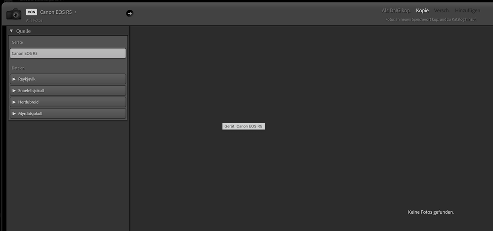

When I open the import dialogue in LrC (11.2) with either the R5 connected via USB cable to my iMac (Retina 5K, 27-inch, Late 2014, running on macOS 11.6.2) or with the SD card inserted in the iMac's built-in SD card reader, LrC does not see any files on the storage cards.
The first picture above shows LrC in Library mode the R5 not mounted although the EOS Utility window on the right to the file locations proves that the camera is actually tethered. The second picture shows the LrC import dialogue. The German words "Keine Fotos gefunden" translate to "No photos found".

Thanks for responding, but it appears you missed the point. I actually don't want to directly copy off camaera. That is just the current workaround (as you discribe it in 1.) because the method for copying off the SD card via card reader does not work.
Of course, I am aware that I need to expand, but even if I try to copy off the SD card via card reader, all I get is what is visible in the first screenshot to the left side of the picture (DCIM-DCIM?; 100EOSSD?)
I am not talking about CFexpress at all, because that card is used for video only, which I do not import into LrC anyway. This is purely about  SD cards which my LrC can't read from directly regardless of off camera or in camera.
Here is what it looks like when I run the import dialoge with the SD card inserted into the card reader (sorry, LrC is set up in German language, but I guess one can figure it out):
Note tha the SD card currently holds 81 raw (*.CR3) files.
