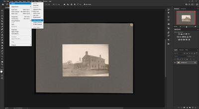

Hi - the TIFF files I want to attach to show you (one I can open, one I can't) are too large, how can I send them to you to compare?
Hi Sahil,
The conversation did not offer me any solutions that worked.
TIFF one I can open,
TIFF two I can't.

@HPLHaverhill I'm using 22.5.2 and couldn't open your TIFF two directly. I was able to open the file from Bridge, to Camera Raw, and then PS. So maybe that will will serve as a workaround for you for the time being? I can't run 23 right now (for different reasons) so I don't know if this method will work with that version. Please let us know if this offers a solution for you. Here is how it came in for me:

There are thousands of files in this series, would like to have a direct fix but thank you this did work, when I clicked on Open in Raw the TIF opened in Photoshop, but when I chose Save As in Photoshop even though it had a .tif extension the default Save As was .jpg. I saved it as a TIF and was able to open it.

I mean I opened it in Bridge like Jain suggested above, then used Open in Raw, then opened in Photoshop.
