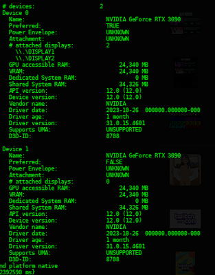

- Manually ran sniffer.exe, it sees the video cards just fine

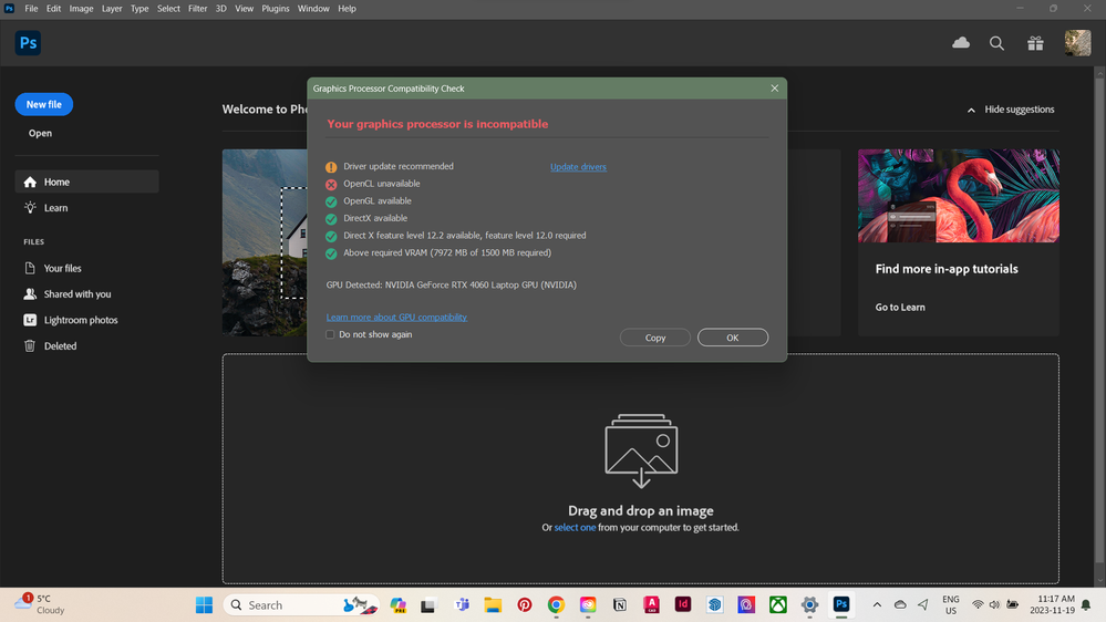

Does anyone know how to fix this? My driver is up to date and I use Photoshop 25.1. I didnt have this problem a few days ago. In the Nvidia control panel under 3D Settings, my preferred processor for Photoshop is set to my Nvidia card and that doesnt seem to fix the problem. Screenshot 2023-11-19 111711.png
