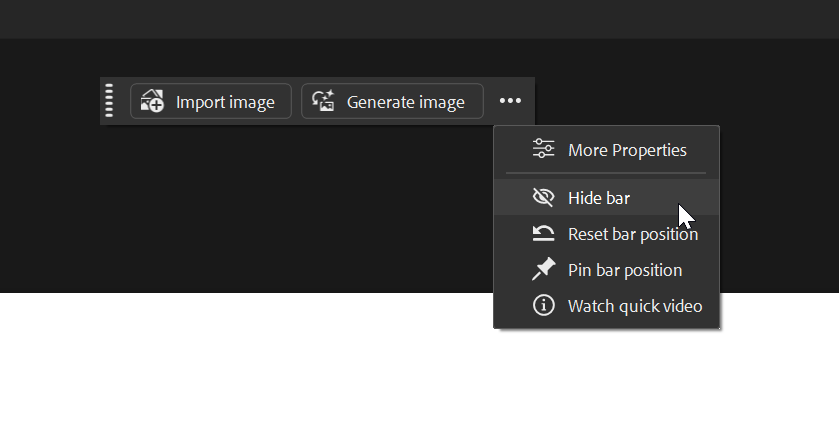

@iSec_1234 it's a known issue, as a workaround hide the contextual task bar

@52658907 it's a known issue with version 26.9, as workaround, hide the contextual task bar

@vitalyn38151610 just hide the contextual task bar and it should work as normal

Thanks for the report, @stevenb91886122 and @mino21. Thanks, also, to @Ged_Traynor and @AxelMatt, for helping speed this up. I can reproduce this with the numeric keypad input. I've shared this with the team for review and comment.

@Ged_Traynor  Thank you for your help and advice, I turned off the panel and it saved me.
Aug 02, 2025 Aug 02, 2025

@Ged_Traynor Thanks. Same issue and your work-around helped.

@C Guerrero it's a known issue with version 26.9, as workaround, hide the contextual task bar

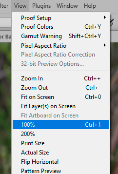

There is an issue with the zoom to 1:1 in the lastest PS edition - Releasing the Alt key first it zooms out to "fit image". Older versions did not have this issue. tested on more PCs.
Issue:
  • Photoshop version: 26.9.0
  • OS: Windows 10, 64-bit
  • PC: Intel I9 13th gen, 64GB RAM, Nvidia 4060
Steps to reproduce:
  1. Open an image which is taller than your monitor's resolution.
  2. Hit Ctrl+Alt+0 to zoom 1:1 pixels.
  3. Release 0, then release Alt, then release Ctrl.
Expected result: Zoom to 1:1 pixels and stay in this zoom level
Actual result: Zooms to 1:1 but upon releasing the Alt key, the image zooms to fit.
Problem: Upon Ctrl + Alt + 0 the image zooms correctly to 1:1 pixels, but after releasing the 0 key, the behavior is not consistent:
- Releasing Ctrl first stays in 1:1 zoom
- Releasing Alt first zooms out to fit
Aug 11, 2025 Aug 11, 2025
The standard shortcut for 100% (1:1) is ctrl+1:
Ctrl+alt+0 seems to work too, but I've never used it. In any case, it doesn't behave like you describe here. It goes straight to 100% and stays there.
Maybe corrupt preferences, which can give very unpredictable and strange symptoms.
EDIT: if you release Alt before the other keys, it's ctrl+0 - which is indeed the shortcut for Fit to Screen.

@NetPixel do you have the contextual task bar opened when performing the above steps, if so try hiding it, I was able to reproduce what you're seeing with that opened

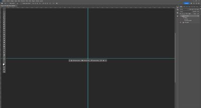

Since the latest update photoshop has some serious buggy behaviour when zooming.
If i press Strg + or Strg - it zooms two times up or down, istead of only once.
And if i zoom out using Strg - and than keep Strg pressed while moving the mouse, it zooms out endlessly until i stop moving the mouse.

@plojscherEinsatz it's a known issue from version 26.9, which hasn't been fixed in version 26.10, a temporary workaround is to hide the contextual task bar
