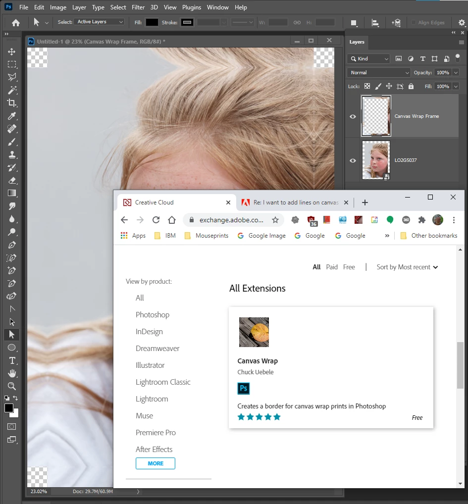

I create gallery wrap canvas prints by cloning the edges of the image - to be used to wrap around the stretcher bars.  I use Perfect Resize to create the cloned images.  The cloned parts are saved as layers. In Photoshop I add some canvas around the image and use the line tool to make marks on the outer edges at the layer edges -  and those will show me where to put the stretcher bars.
I have been doing this for years - but lately I cannot keep the lines when I flatten the image or when I send it to my printer.  I used to flatten the image and the lines would reamin.  Now they disappear ... Did the line tool change???

解決に役立った回答 JJMack
Yes Adobe broke the line tool in 2021. You can probably use the rectangle tool for your line will be vertical and horizontal.
Chuck's Canvas Wrap Frame Script  is quick, easy, free, but his script does not create any lines for position stretches

Yes  The rectangle tool works ---
Thanks

Is it Chuck Uebele site?
