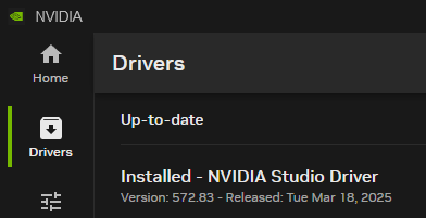

Explorer ,
Apr 11, 2025 Apr 11, 2025
@jamieclarke
The latest Studio driver 572.83.
