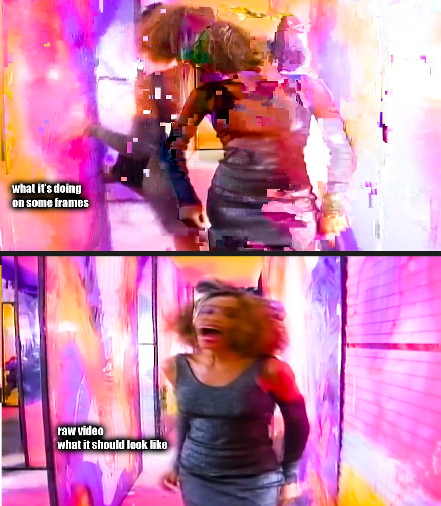

There seems to be an issue with Premier that does weird things to the video, edited on a timeline.
The original video does not have the issue.  It is clean.  (see attached same frame of original in quicktime, and same frame on premier)
So it randomly does this.  Once it happens on the timeline, it stays there.  Even with render in to out.  Even after exporting in various codecs (pro res, mov, H264, etc..)
I see other are having this issue too.
How do I fix this, without having to edit this in another app?
I did try rebuilding the cache, and still not working correctly.adobe-bug 2.jpg
I am re-sizing video files, and they seem to be ok, until I start chopping them and editing them.  Then I start getting random pixelations.
It happens in the timeline video.  Even after rendering, it's still there.  Only way to get rid of it is to re-do all the work.
