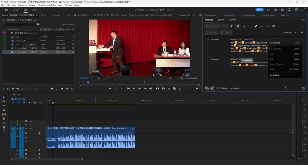

Community Beginner ,
Feb 28, 2024 Feb 28, 2024
Although the version is updated to 24.4, the problem still exists.02.png01.jpg
