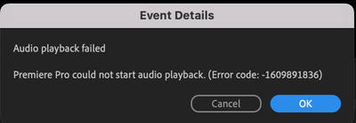

Any video I upload gets the 'audio playback failed' error message (and says Premiere Pro could not start audio playback errror code 1609891836) when you click play. The app doesn't recognise audio in any of my videos and wouldn't even play. Please see attached image. Can you please help me troubleshoot?

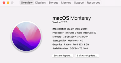

I'm having the same issue with playback and also exporting audio. I've had to output via Media Encoder to get rendered audio in my exported videos. I've run the system compatability and no issues reported there.
macOS Monterey 12.7.5
iMac Retina 5K 27-inch 2019
3.6 GHz 8-core Intel i9
Ram 72 GB 2667 MHz DDR4
Radeon Pro 580X 8 GB
Neil Wieteska

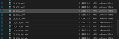

Jul 25, 2024 Jul 25, 2024
 I've posted about his previously and still having these issues.
Premier 24.5.0
Here's a screen shot of audio information ( or at least what Premier thinks of it)
And another screen shot of prores files
Any ideas?

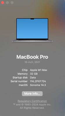

New Here ,
same problem... Audio playback for any audio does not work.2024-07-26_02-41-52.jpg2024-07-26_02-55-59.jpg2024-07-26_02-56-39.jpg

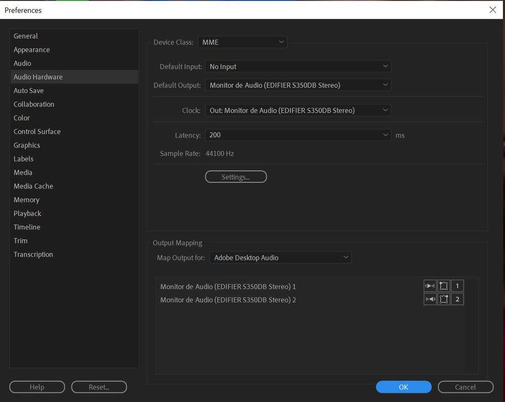

Jul 28, 2024 Jul 28, 2024
Same problem... Do we already have the answer? ty

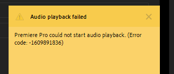

After the latest update my Premiere Pro will not read, display, nor playback audio from MP4 files. I receive the following error code -1609891836.
BRAW and MOV files are fine. After Effects also does not read/play audio from MP4s. But Audition will read the audio tracks. This is on my Windows 10 machine.
