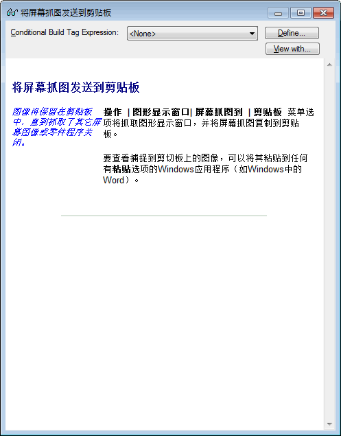

Here's what the localized table looks like in the RH editor:

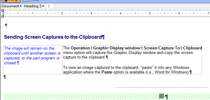

By comparison, here's the equivalent English topic prior to localization:
Our CHM output is fine. In fact, here's what the Chinese looks like in when output to a browser or previewed and I drag the right side to
a narrower width. Notice that the table text appropriately wraps to remain within the window's size:

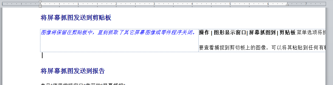

But here's what it looks like when I generate it in Word's printed output:
Notice the location of the margin at 6.5 inches. It should be wrapping at the margin. And something is weird with the left cell how it's getting pushed so far to the right.
The actual table width ends up around 11 inches! I had some tables last time I did this that were as far out as 18 inches but looked perfectly fine in English!
