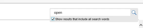

Hi - Can anyone help me on this please? Originally posted 24th August but no replies.
Thanks
I am using responsive HTML5 help in Robohelp 2015. There is an option for users to tick a box for all search words for an AND search otherwise the default is OR.
Can this be set as default - so that the box is automatically ticked for an AND search?
There isn't an option for this so I guess it will require a code change but I haven't manage to locate the code yet.
Thanks
* I see the same question has been asked for Robohelp 11 but the solution given doesn't seem to work for Robohelp 2015.

解決に役立った回答 Willam van Weelden
I'm not sure if it has to do with Update 4, but you never know...
I mean exactly what your image shown: checking AND search by default.
For the output, please contact me at: contact [at] wvanweelden [dot] eu.
I looked into the output and it seems that setting the value doesn't always correctly change the checkbox value. But there is a 'workaround'. By mimicking a user interaction, you can set the AND search when the page is loaded.
In the layouts usersettings.js file, go to line 35, with the text rh.model.publish(xxxx
Add a new line below that and add the code:
setTimeout(function(){
  var rh = window.rh;
  var isAND = rh.model.get(rh.consts('KEY_AND_SEARCH'));
  if(isAND != 1) {
  var checkbox = document.getElementById('andsearch');
  checkbox.click();
  }, 1000);
