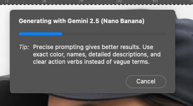

Rav052024WhLED
Oct 31, 2025 2:19 AM UTC
The same happened to me. Generative Fill is not working with partner models. Attached is the screenshot. The progress bar went halfway and then disappeared. It never completed the process.
