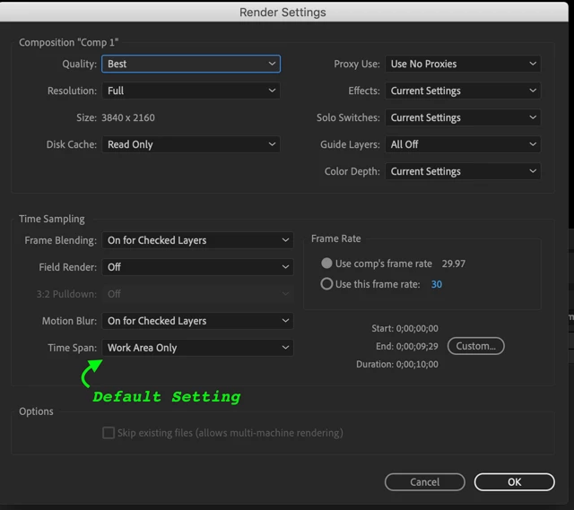

Have you checked Render Settings and Work Area? It is pretty easy to hit the N key when you are at the first frame so the work area is now one frame. The default Render Setting is to just include the Work Area. I don't see any error messages in your screenshots.
Are you still getting the "Baaaa" sound? Have you tried turning off all effects or turning off layers? What happens if you change the comp settings to the default HDTV setting that matches your frame rate? What happens if you make a new comp with the default settings and only put your footage in the comp? What happens if you try and export a frame as a PSD? What happens if you try and export an image sequence using one of the presets in the Output Module?
