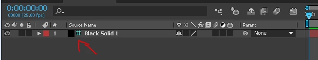

they don't show up when I watch the rendered video.
a common user error is to accidently check the layer as Guide layers.if you see this symbol
then right click on the layer and check off "guide layer"
if this is not the case, show us a full screenshot of your Ae interface so we can examine it.

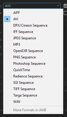

The file type I exported it as is AVI because it doesn't show any other options when I render the video.
this does not sound normal. where is this video going? if you are creating a lossless file you are better off using Quicktime and for a codec - Animation is a popular one. you need to install Quicktime to have these options. (on Windows you had better install just the essential components because there are some security issues associated with Quicktime player). if your intention is to playback the video for your entertainment of upload to some service online, then you should export using Adobe Media Encoder and you don't have to render it in Ae before you do that. see here for exporting options in Ae: Basics of rendering and exporting in After Effects CC

To answer your question: I will be posting the video on youtube. Here are all the options that AE gives me to export video as:
I'm not sure what one is best for uploading to youtube but I have previously uploaded AVI videos to youtube and they worked just fine. Thanks so much for the help!

2. if you want to export you video to a playback codec you should encode it to H264 using adobe media encoder. more about here: https://helpx.adobe.com/after-effects/using/basics-rendering-exporting.html
